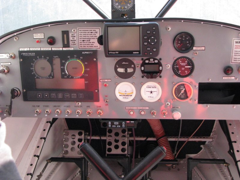

Coop your in a different world now so you can almost do what you like. Certainly when it comes to the instruments in a 19 aircraft. I have totally electronic dash now but have made a new one I am about to install very soon after getting mine flying today after a dual stick mod. Ask Bill about it on Sunday he signed off on it today and also came with me on the test flying. My new dash has 2 of MGL Xtreme one set for normal AHRS the other set for total instruments for the engine. A mini iPad in the dash in a special mount. and my Avmap EKPV in a dash mount as well. I do have a analogue ASI in the dash just in case of all electric failure
Mark

Coop this is the dash I started with. I didn't use any of the instruments supplied in the kit except the fuel pressure gauge...it changed after some use to have the MGL Xtreme added. I liked it so much that is why I decided to add another one . reason was redundancy as both are EFIS so they can both do EMS as well
This is how I have been flying it now for about 2 years and I will get some pics up of the new one..minus the second EFIS as it is in my aircraft of course
