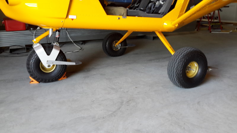

Downunder Posted January 18, 2015 Posted January 18, 2015 I have the tundra tyres. They will fit on standard main rims but require a different "front end". I know of one foxbat where the main only were changed. Seemed to work fine. It is a factory option. 2 1

Forest James Posted January 18, 2015 Author Posted January 18, 2015 I have the tundra tyres. They will fit on standard main rims but require a different "front end".I know of one foxbat where the main only were changed. Seemed to work fine. It is a factory option. [ATTACH=full]33722[/ATTACH] Hi Downunder, thanks for your post, in your attachment they show the 8" tyres on the 6" wheels which are not what I had in mind. Tundra tyres are far bigger but thanks anyway, James.

Robertvn Posted March 15, 2016 Posted March 15, 2016 I have the tundra tyres. They will fit on standard main rims but require a different "front end".I know of one foxbat where the main only were changed. Seemed to work fine. It is a factory option. [ATTACH=full]33722[/ATTACH] Hi Downunder Can I ask what size are the tyres and/or rims and what brand are they? Cheers Robert
Downunder Posted March 15, 2016 Posted March 15, 2016 Carlisle turf glide tyres. See the wagga bike tyres add on this forum. Rims are standard Foxbat matco....
