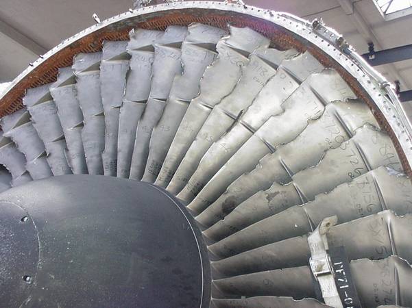

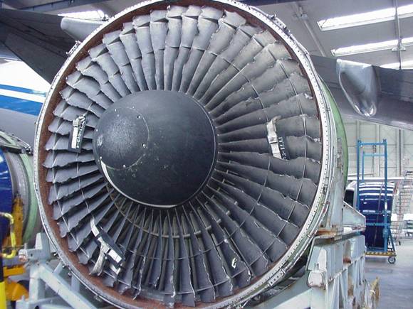

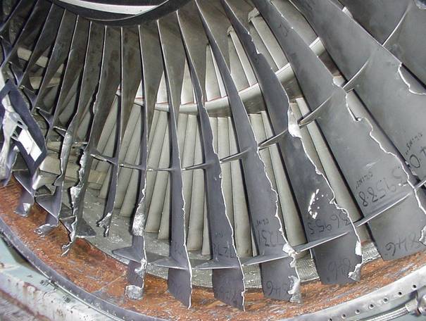

A pilot for a Chinese carrier requested permission and landed at FRA ( Frankfurt , Germany ) for an unscheduled refuelling stop.
The reason soon became apparent to the ground crew:
The Number 3 engine had been shut downpreviously because of excessive vibration, and because it didn't look too good.
It had apparently been no problem for the ground crew back in China, as they took some sturdy straps and wrapped them around some of the fan blades and the structures behind, thus stopping any unwantedwindmilling engine spinning by itself due to airflow passing through the blades during flight and the associated uncomfortable vibration caused by the sub optimal fan.
download?mid=2_0_0_1_1651463_AJoIDNkAABF%2BVMPVwgz0aHYyuQw&m=YaDownload&pid=4&fid=Inbox&inline=1&appid=yahoomail
Note that the straps are seat-belts, how resourceful.
After making the "repairs", off they went into the wild blue yonder with another revenue-making flight on only three engines.
With the increased fuel consumption, they got a bit low on fuel, and just set it down at the closest airport (FRA) for a quick refill.
That's when the problems started:
The Germans, who are kind of picky about this stuff, inspected the malfunctioning engine and immediately grounded the aircraft.
Besides the seat-belts, notice the appalling condition of the fan blades.
The airline operator had to send a chunk of money to get the first engine replaced whichtook about 10 days.
The repair contractor decided to do some impromptu inspection work on the other engines, none of which looked all that great either.
The result: a total of 3 engines were eventually changed on this plane before it was permitted to fly again.
And you all were worried about toys from China with lead paint on them.

You can fly on three engines , but the max weight would be severely compromised by the need to perform with one more failure. I think it would be ferry only, and with specific permit. That sort of fan blade damage looks like it ran into a steel structure. but maybe it's hail. Nev
Origins: The photographs displayed above have been circulated since at least as far back as 2001, in versions with text attributing them to Air China as well as a number of different airlines, in each case accompanied by the claim that a ground crew had
hastily (and dangerously) repaired damaged jet engines on one of the airline's planes by using seat belts to hold them together, and the plane had taken off on a commercial flight in that state. While the pictures do show an engine that has been removed from an aircraft, when and where they were taken (and whether they have any connection to Air China or any other airline) is unknown. Nonetheless, they do not document a case of substandard repairs or an occurrence anything like the circumstances described in the accompanying text. The pictures included in the e-mail show engine fan blades that have suffered foreign object damage (FOD) such as encountering a bird strike or a hail storm, and the "seatbelts" are tie-down straps used to secure the engine to a shipping stand as it is removed from the aircraft for inspection, repair, or replacement.
Read more at http://www.snopes.com/photos/airplane/airchina.asp#D8DmvUDCe5jleUXS.99
  Quote
Origins: The photographs displayed above have been circulated since at least as far back as 2001, in versions with text attributing them to Air China as well as a number of different airlines, in each case accompanied by the claim that a ground crew hadhastily (and dangerously) repaired damaged jet engines on one of the airline's planes by using seat belts to hold them together, and the plane had taken off on a commercial flight in that state. While the pictures do show an engine that has been removed from an aircraft, when and where they were taken (and whether they have any connection to Air China or any other airline) is unknown. Nonetheless, they do not document a case of substandard repairs or an occurrence anything like the circumstances described in the accompanying text. The pictures included in the e-mail show engine fan blades that have suffered foreign object damage (FOD) such as encountering a bird strike or a hail storm, and the "seatbelts" are tie-down straps used to secure the engine to a shipping stand as it is removed from the aircraft for inspection, repair, or replacement.
Hey FT, don't let the truth get in the way of a good story.
