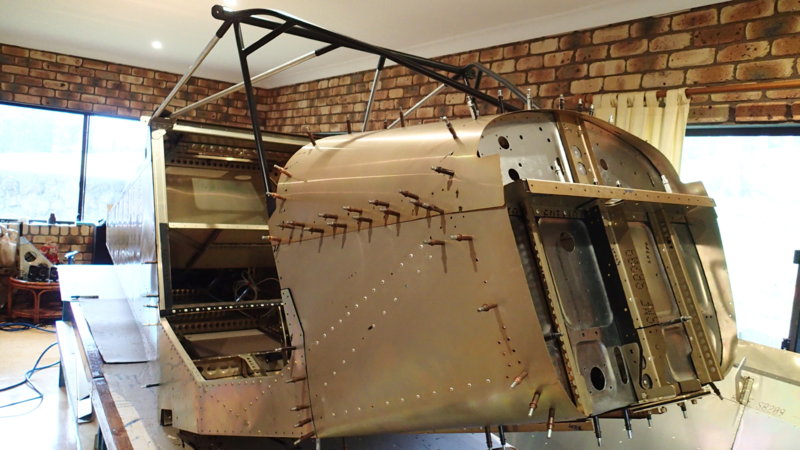

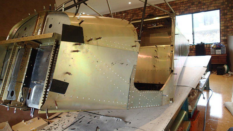

I seem to be having trouble lining the holes up. I was told to get a tapered Mandrel and get quite brutal. Have try but still can't see how the holes will line up without redrilling.
Was wondering if other builders had the same problem and how they got around it.
Maybe I just to get more brutal?
  • Helpful 1
Always a struggle getting those brackets to fit all the holes, the last one I did the rear three outside holes were so far out I got them welded over and drilled new holes. Did you try lining up the outside holes before the channel holes, the channel holes are more receptive to moving with the taper.

Yes I did try lining the holes up before I bolted the channel holes but no go. I notice that the side sheeting isn't quite as straight because of the force i use to try and line the holes up as to the other side where I didn't use any force but both sides are the same when it comes to lining up the holes.
Good idea Rick on the welding so going to pull them out and weld the front holes as they're are the big problem, the rear holes I think I can work the bolts in somehow.

Lining the holes up before I bolted the channel holes must have been a half hearted attempt Rick. Loosing the channel bolts and having a length of pipe on the multi-grips for leverage did the trick and all bolts are in. No need to weld.001_smile.gif.2cb759f06c4678ed4757932a99c02fa0.gif

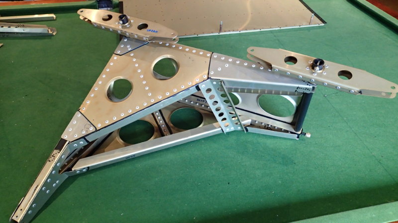

Second wing nearly finish and has since been riveted up. [ATTACH=full]34788[/ATTACH]
Nice Aldine job.......

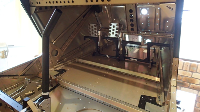

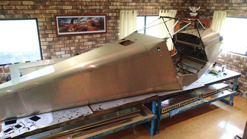

Today been a little wet so decided to get back into the swing of thing after very little activity the past few weeks. So got all the bits for the doors and started the jigsaw puzzle and here's the end results. Next on the cards will be the wheels and undercarriage I think.

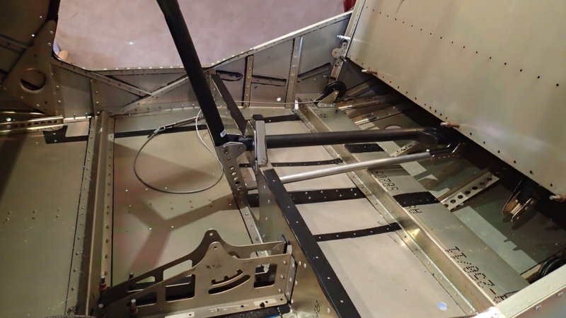

The adjustable seats are a work of art and with a bag full of bits and me thinking there's too many parts for just 2 seats but hey all slot together nicely and feels and looks super strong finish. The seats can also be tilted forward to exposed the inspection panel underneath the seat when install, a neat set-up.
The wheel rims were another story and the instructions telling you to drill a hole for the inner tube nibble which the ones supplied have the nibble offset and when there is already a hole in the center of the rim which they give you a plug to fill that hole. Upon drilling the hole I found I couldn't get the tire on enough to get the nibble in- 2 hours of trying and cursing and then when that fail I took the rims into my local tire mob they couldn't get the tire on either but said I should've just got new inner tubes with the nibble in the center and use the existing hole, be easy then. Have since welded up the hole I made. Just making mention for future Savannah builders.

Not sure of the weight difference eightyknots between the fix and adjustable seats but being able to adjust rather than one size fits all and being able to easy take the seat out is worth the extra weight in my book.
Seats ready for covering and me taking them for a quick test flight.
Love the joystick. Hope you scrubbed the deck while you were down there! 003_cheezy_grin.gif.c5a94fc2937f61b556d8146a1bc97ef8.gif
