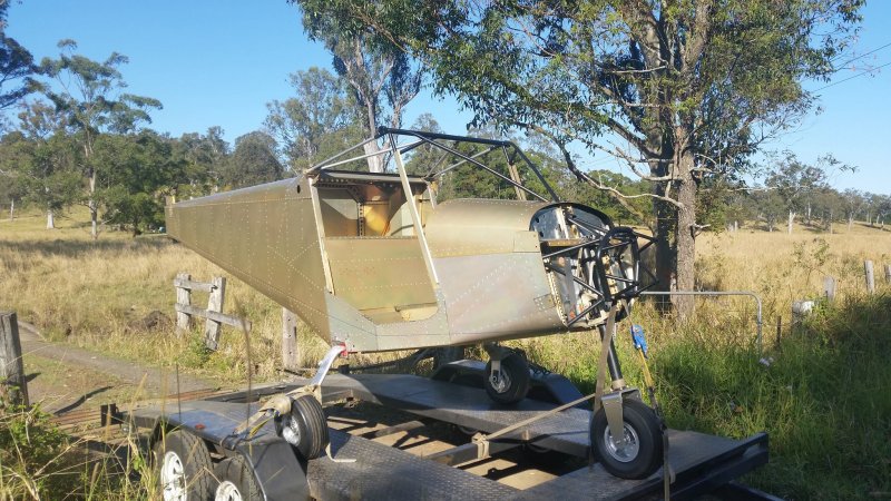

Guy s Posted September 17, 2015 Author Posted September 17, 2015 The fuselage just leaving for the Spray painters, this was 3 weeks ago and was told it should be ready to pick up tomorrow so pretty excited. It's been a painful run dealing with the Spray painters as it will take longer to get it painted that it took me to build it to this stage. Maybe I just need to take a chill pill I have the UlS Rotax arriving next week and wondering what props people are running in the Savannah's ? I have inquired about the Bolly In-flight adjustable prop 70 inch= better climb or the 66 inch Bolly with better cruise speed
