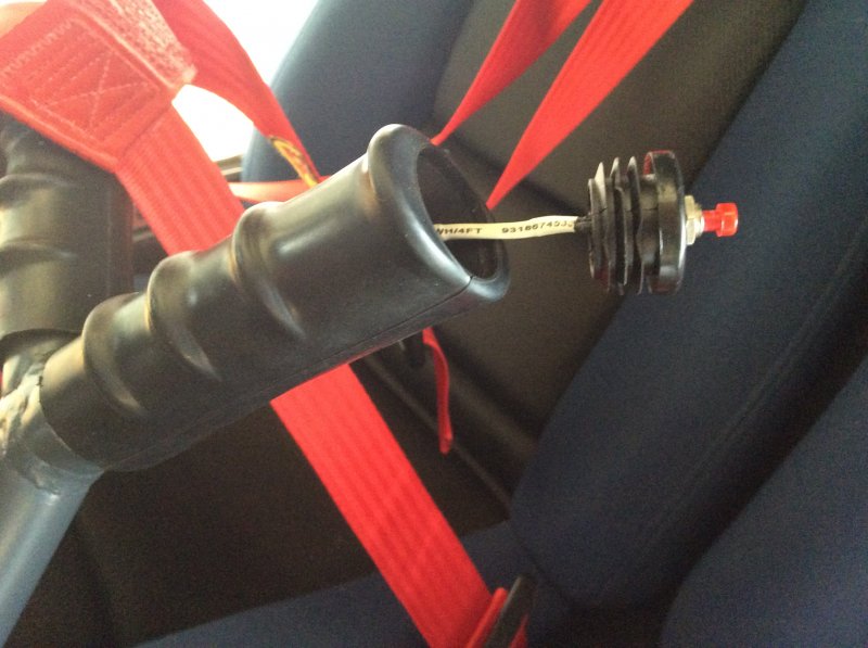

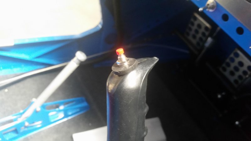

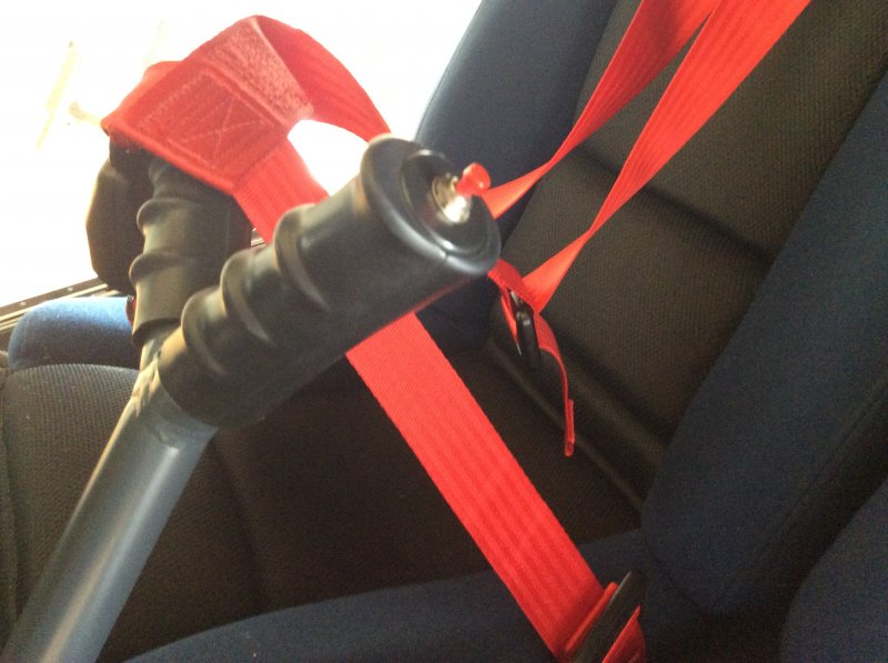

eightyknots Posted March 22, 2016 Share Posted March 22, 2016 That's what I do, cut the top off the grip and sand it smooth, put on in the stick upsidedown (best side up), get a correct size plastic pipe stopper with push button fitted and put in open end of stick. Works well. Will post a photo if you want. That will be useful! Link to comment Share on other sites More sharing options...
rick morawski Posted March 22, 2016 Share Posted March 22, 2016 That will be useful! Will have to go out to the airstrip to take the photo tomorrow after the dog clippers been. Link to comment Share on other sites More sharing options...

rick morawski Posted March 23, 2016 Share Posted March 23, 2016 That will be useful! Photos as promised! Can't keep Paws'n'Claws waiting. I clip my own, style cut usually. Well worth waiting for the dog groomer, she's gorgeous 3 Link to comment Share on other sites More sharing options...
Guy s Posted March 23, 2016 Author Share Posted March 23, 2016 Here my transmit set-up, sliding the button inside the rubber grommet which fits nicely into the hand grip Link to comment Share on other sites More sharing options...

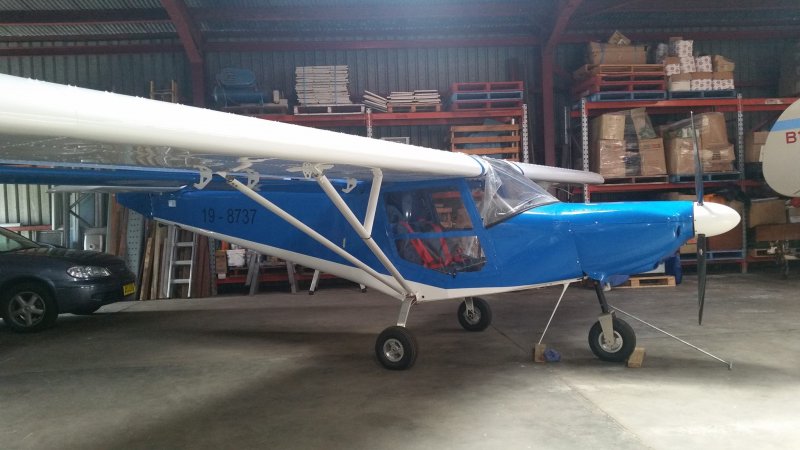

Guy s Posted April 26, 2016 Author Share Posted April 26, 2016 Just a quick update, the Sav is basically finish with a few minor things to finish off before I get it inspected and signed off, which will hopefully happen in a few weeks. 1 1 Link to comment Share on other sites More sharing options...
rankamateur Posted April 26, 2016 Share Posted April 26, 2016 Way to go. You haven't mucked around lately, I could use a bit of your momentum. Link to comment Share on other sites More sharing options...
Guy s Posted April 26, 2016 Author Share Posted April 26, 2016 Way to go. You haven't mucked around lately, I could use a bit of your momentum. Well you better get cracking Steve so we can go flying together. the Dynamic Duo Link to comment Share on other sites More sharing options...
eightyknots Posted April 26, 2016 Share Posted April 26, 2016 [ATTACH=full]42716[/ATTACH]Just a quick update, the Sav is basically finish with a few minor things to finish off before I get it inspected and signed off, which will hopefully happen in a few weeks. It's a lovely looking bird, Guy! 1 Link to comment Share on other sites More sharing options...
