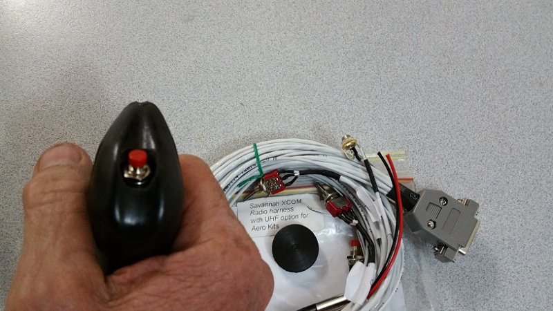

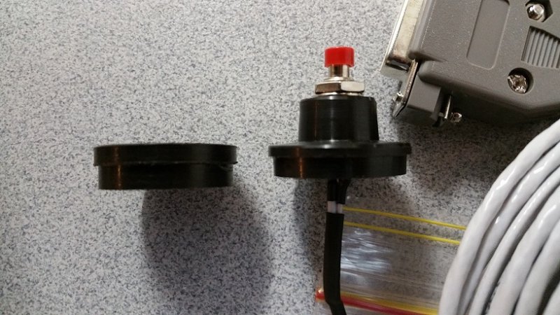

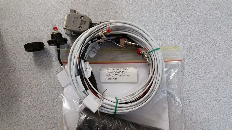

rankamateur Posted April 29, 2016 Posted April 29, 2016 Here my transmit set-up, sliding the button inside the rubber grommet which fits nicely into the hand grip I did mine with a nylon bush, the outer diameter is 28.6mm, step is 26.6mm, the riser is 16mm diameter and rises 9mm. The hole up the middle is 11mm reduced to 6.25mm where the nut seats. 1
dan tonner Posted April 29, 2016 Posted April 29, 2016 Nicely done Rankamateur; Did you turn the nylon bush and the spacer yourself or were these supplied with the XCOM kit? I am at exactly that point with my MGL radio and would like to use the grips that came with the Savannah. Fly safely, Dan
Guy s Posted April 30, 2016 Author Posted April 30, 2016 Ran the motor for the first time and sounded sweet and grunty. Had one fuel leak which was promptly fix then did some taxi around a bit to get the feel of brakes, steering etc. Was very tempting to give full throttle and go do a few laps but luckily commonsense prevail. Looks great Steve and yea I'm also interested if you made the the nylon bush yourself or you can buy them like that. 1
rankamateur Posted April 30, 2016 Posted April 30, 2016 Did you turn the nylon bush and the spacer yourself or were these supplied with the XCOM kit? I did it myself Dan, that is why I included the measurements so you can do it too. The Xcom kit could come with a bush as part of the custom Savannah wiring kit, but it doesn't. It didn't even have the screws to mount the radio in the panel which is disappointing. Edit: I did reply last night, but didn't hit post sorry.
rankamateur Posted April 30, 2016 Posted April 30, 2016 I did mine with a nylon bush, the outer diameter is 28.6mm, step is 26.6mm, the riser is 16mm diameter and rises 9mm. The hole up the middle is 11mm reduced to 6.25mm where the nut seats. I mounted it in the plane today, I think it would be better if it rises 10mm instead of 9mm. It is quite usable but an extra millimetre would be better. 1
