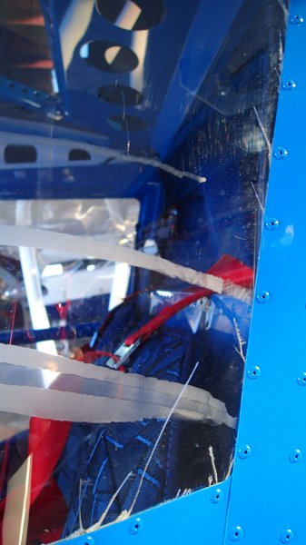

The first 2 photos is what happens when you leave the door open and overfill your tanks and it runs onto the door-BUGGAR

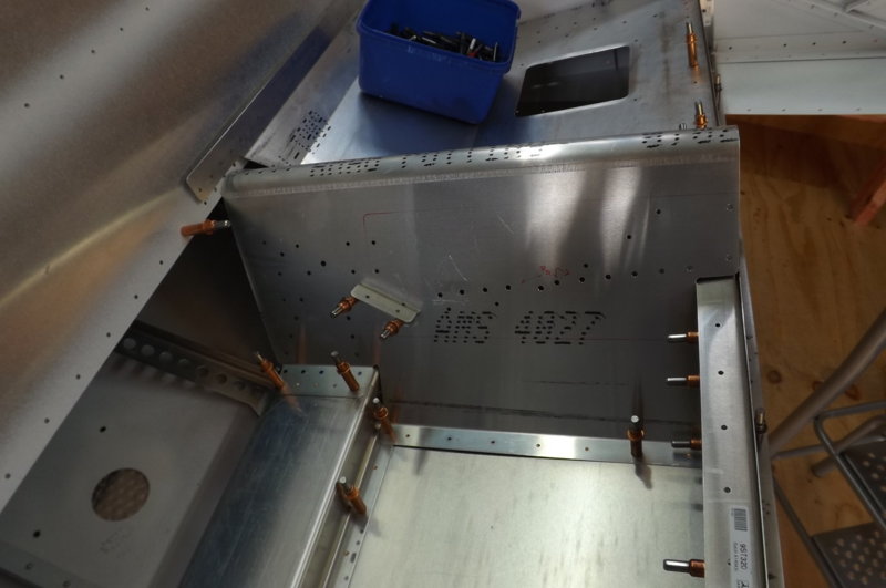

I am currently fitting the panel/s under the seats, ST330/331, the ones with the rectangular hole in the middle.
With the front of the panel clekoed in place, non of the holes on the left or right of the panel line up with the holes in the mounting brackets: that is, looking through the holes in the panel, I can't even see the holes in the brackets.
I also cannot see how the back of this panel can be brought down far enough to be riveted along the back edge.
I have been moving slowly on the Front Fuselage, all clekos, no rivets so far. I am pretty sure it is assembled correctly.
Did you strike anything like this?
Sorry Bob cant help its pretty different to mine but fitting the bracket at the rear of the tunnel on my version was a issue...you have to use the podger pretty hard to make it line up on the bracket that goes onto the top of the hump section

Thanks Mark. I posted to Guy as he has the adjustable seats, but all input is very welcome!

Mark...this will be the part you were referring to.
Hard to see how it's going to work: as you can see, the holes in back panel are level with the top of the tunnel, while the holes in the bracket are 12mm further up. I'm starting to think I may have an incorrect part here,,,but which is it???
Yes thats the part....I think I did refer in my blog to it....basically the top of the hump gets flatted a bit otherwise it just wont fit...everyone who has built one has just done the same thing
