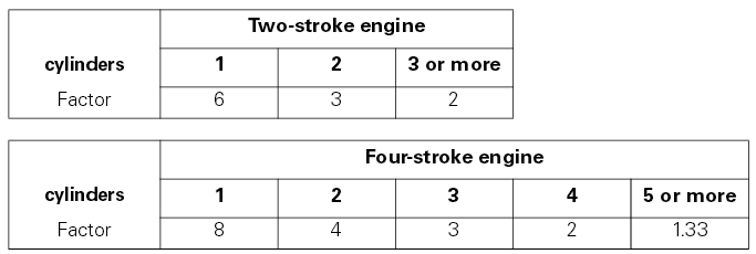

facthunter Posted April 21, 2015 Posted April 21, 2015 Engine mounts are designed basically relating to engine weight relating to manoeuver loads. (pick your figure) This is a much higher figure than vibration allowances might require if they could be evaluated easily They certainly affect component life where fatigue is a consideration, particularly high frequency vibrations. Carrying engines and fuel in the wings enables a lighter structure. Nev
kasper Posted April 21, 2015 Posted April 21, 2015 Engine mounts are designed basically relating to engine weight relating to manoeuver loads. (pick your figure) This is a much higher figure than vibration allowances might require if they could be evaluated easily They certainly affect component life where fatigue is a consideration, particularly high frequency vibrations.Carrying engines and fuel in the wings enables a lighter structure. Nev maybe so but take a look through BCARS and you will find load factors in teh design test requirements that are related to the number of power pulses per revolution of the engine ... factually you may be thinking along the is it going to shake itself to bits BUT when you do the load tests on the structure IF you are certifying it then you are up against power pulses ... similar applied the JAR reqs.
facthunter Posted April 21, 2015 Posted April 21, 2015 This has more complexity than we can go into here. As I understand it there isn't a formula used on our type of designs. going from memory on Bill Whitneys material, that goes into the pulses. I don't believe they are of a high order without harmonics happening. Gyroscopic loads On C-180's doing quick turns on the ground were breaking crankshafts over time caused by the bending loads and fatigue imposed by the gyroscopic precession. A single cylinder engine (there have been some) might impose some higher torsional "shakes" that require some consideration. IF you can allow the engine to move in it's mounts a fair bit you are only resisting something close to the torque figure for the engine, and the thrust. IF you chuck part of a prop blade or get ice on it shedding unevenly it will shake enough to make the instruments unreadable. I'm sure those loads are way higher than anything caused by power pulses.Nev
kasper Posted April 21, 2015 Posted April 21, 2015 OK but BCARS - or CAP 482 to give it its real name is very clear on what I noted: "S 361 Engine torque a) The engine mount and its supporting structure must be designed for the effects of: 1) The limit torque corresponding to take-off power and propeller speed, acting simultaneously with 75% of the limit loads from flight condition A of S 333 b) [and including the effects of engine thrust where this is critical]; 2) The limit torque corresponding to the maximum continuous power and propeller speed, acting simultaneously with the limit loads from flight condition A of S333 b) [and including the effects of engine thrust where this is critical] b) For conventional reciprocating engines with positive drive to the propeller, the limit torque to be accounted for in S 361 a) is obtained by multiplying the mean torque by the appropriate factor from the following tables: NOTE: ‘Positive drive’ includes direct drive, gear drive or toothed belt; for other drives (e.g. centrifugal clutch) and unconventional engines the appropriate factor must be agreed with the CAA."
facthunter Posted April 21, 2015 Posted April 21, 2015 They have a formula, and you just apply it if you want to pass their rules. They are like that. My point is torque and thrust are low order forces and no matter how you play with them won't be hard to cope with. I mentioned a single and their treatment of it is consistent with what you would expect. What actual forces are transmitted to the engine mount will depend a lot on the rubber mounting and it's ability to absorb shock. . Nev
