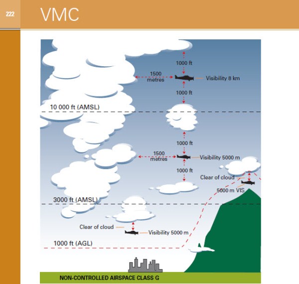

mnewbery Posted April 25, 2015 Posted April 25, 2015 Another one. If the cloud goes 45 degrees left to abeam left, however long it took in minutes to do that is the distance you were away when you finished timing. So those of us doing 90 knot or 1.5 nautical miles a minute are 3 miles away from that pesky cloud if it takes 2 minutes. 3 nautical miles is 5430 metres
dazza 38 Posted April 25, 2015 Posted April 25, 2015 Quote 5000 metres is close to 3 miles, could you use your normal sight picture of "3 mile final" to roughly judge that distance from a cloud? True but I wouldn't bother, it is one of those rules that isn't really policeable. 1
dazza 38 Posted April 25, 2015 Posted April 25, 2015 Quote 5000 metres away is 200 seconds at 25 metres per second, 90km/h or 48KTAS. Double the speed halves the time.If at 48KTAS a cloud appears to move from 45 degrees in front of your left wing to abeam your left wing in more than 100 seconds, it's more than 5000 metres away. If not, it's closer, assuming you are straight, level and cruising. I don't have a PPL and I know this. It's also in my PPL syllabus. Once you know the horizontal distance, going from one hand span above the glare shield to two hand spans is roughly 5 degrees. We know your descent angle is 3 degrees at 100 knots and 500 feet per minute or 48 knots and 240 feet per minute. So if the cloud in front of you goes up the screen by a hand span a minute and it's in front not above you ... Maths. ... At 48 knots it is 400 feet above you. At 100 knots it's 830 feet above you. Excuses for certificated pilots not knowing this? Anyone? Why would you bother ? I have more important things to keep an eye on when flying around than worrying if this cloud or that cloud is 4800 metres away or 5200 metres away or 1000 or 1500 metres away ect. 3

dazza 38 Posted April 25, 2015 Posted April 25, 2015 Everybody is different but when i'm above 3000 feet, I just use judgment/ guesstimate whether a cloud is further away than 1500 metres. Each to their own though, if pilots want to be more accurate, fair enough. 2
SDQDI Posted April 25, 2015 Posted April 25, 2015 I'm with you on this one Daz, I mean we all know inside when we are in the clear and when we are skirting a bit close. The more calculations you are trying to do the more likely you could inadvertently get too close, after all if the clouds are getting closer, thicker or lower you will be already working on your alternates so the workload will be high enough without complicating things. 1 2

turboplanner Posted April 25, 2015 Posted April 25, 2015 Quote Just a question, how do you judge the distance from cloud base without actually flying to cloud base and noting it (illegal). Relying on the aviation weather forcast is fine but conditions change? Quote 5000 metres is close to 3 miles, could you use your normal sight picture of "3 mile final" to roughly judge that distance from a cloud? I agree with Facthunter that formulae can lead to a Human Factors error when you are under stress, and I think Ayavner's answer is the way to go becaise that builds the "feel" into your subconscious and you can be assessing the distance to cloud on a bad day automatically, leaving your conscious available for spotting potential Precautionary landing sites, map checking, flight planning for Alternates etc. Just following on from Ayavner, 3 miles is not that much different to the length of a Downwind Leg, and you can practice a couple of three mile legs when you are out in the training area. You'll probably find that it doesn't take too much practice to get the distance into your brain, and this in turn will give you more confidence on a bad day. Going back to the Downwind Leg equivalent - that's a very comfortable space to do a 180 in. The picture below comes from the Visual Flight Guide

facthunter Posted April 26, 2015 Posted April 26, 2015 1500 meters isn't very far. If you know of a distance in your locality which is 1500 meters or close , relate to that conceptual distance, as a basis for your estimate. You are doing this automatically doing circuits unless you do all of them at the one place or somewhere you are familiar with, when you cheat and use known features in the circuit as references. you CAN time your circuit or you can look behind at the strip and judge your distances and turn points. You also confirm your tracking accuracy this way, in the circuit. ( Another post sat for a day . Hope it still makes sense.) Nev
