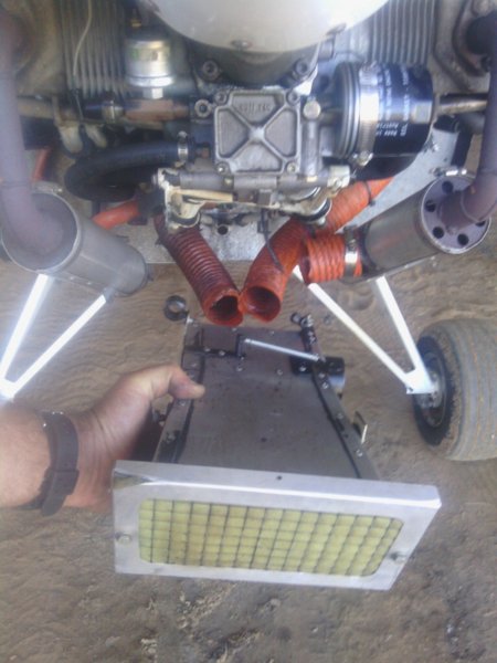

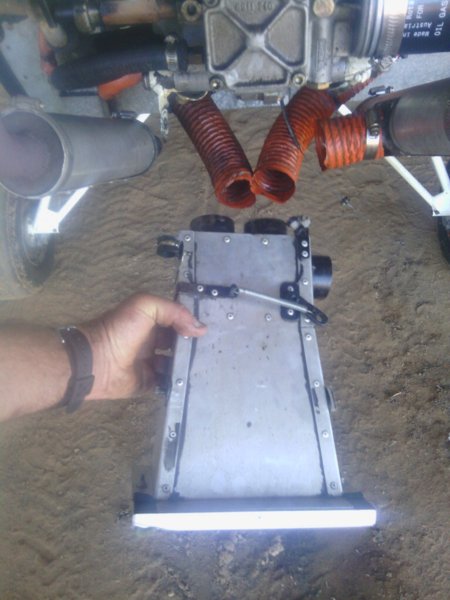

Old Koreelah Posted May 5, 2015 Posted May 5, 2015 One of our members has a 55-reg Skyfox with a 912. He is not happy with its carby heat setup and wants to replace it with something better. He likes the idea of a collar around the carb running hot water from the heads. 1. Is he allowed to modify a 55- reg? 2. If so, can anyone suggest a more reliable/efficient carb heat system?

planesmaker Posted May 5, 2015 Posted May 5, 2015 What's wrong with the original? It is a certificated aircraft.
