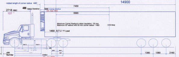

Geoff13 Posted May 21, 2015 Posted May 21, 2015 Just leaving aside the Morgan design, and talking about the principle of using FRP and steel or aluminium in combination.There is no bond to break; you'd have as much success bonding FRP to aluminium with polyester resin as getting a pelican to breathe under water. There has to be a mechanical entrapment As far as "guessing" and "no empirical evidence available", I can tell you about the design of one piece moulded, frame-free sandwich construction refrigerate vans where Australia leads the world, because I was directly involved in it. When you see one of these on the road, have a look at the refrigeration unit, it's bolted to two pieces of MS flat enclosed in the FRP. In the semi trailer refrigerated vans, the lights, heavy duty door hinges and cam locks are all bolted to small, localised steel plates, as are the skid plate and the tri axle suspension. The one piece FRP box is structural, has no chassis. About 14.5 tonnes static load is going through the skid plate and about 17 tonnes through the tri axle suspension. As for empirical evidence, the first of these went on the road about 50 years ago; most are still in service. [ATTACH=full]35748[/ATTACH] FTE I think it was pioneered that setup, although I may be wrong. I can't recall seeing to many still around over 15-20 years old though.
turboplanner Posted May 21, 2015 Posted May 21, 2015 FTE I think it was pioneered that setup, although I may be wrong. I can't recall seeing to many still around over 15-20 years old though. Reinforced Plastics Pty Ltd built the first and converted the market from the much less efficient steel/aluminium framed vans, and were joined by Athol Hedges Pty Ltd, a Brisbane based builder. FTE was started some years later by the RP General Manager, and one of the draftsmen, still make them, and do a magnificent job. Some of the 1965 vans have been on 7 or 8 cab/chassis, and usually the only maintenance required is a repaint. A few have been lost in major accidents, and several more failed after minor skin damage which was not repaired, allowing water in to the sandwich panel destroying it. I keep a watch around the eastern states, the old ones - RP and Athold Hedges can be identified by their front clearance light recesses, and I'd suggest that about 80% of all production is still in operation.
Geoff13 Posted May 21, 2015 Posted May 21, 2015 Reinforced Plastics Pty Ltd built the first and converted the market from the much less efficient steel/aluminium framed vans, and were joined by Athol Hedges Pty Ltd, a Brisbane based builder.FTE was started some years later by the RP General Manager, and one of the draftsmen, still make them, and do a magnificent job. Some of the 1965 vans have been on 7 or 8 cab/chassis, and usually the only maintenance required is a repaint. A few have been lost in major accidents, and several more failed after minor skin damage which was not repaired, allowing water in to the sandwich panel destroying it. I keep a watch around the eastern states, the old ones - RP and Athold Hedges can be identified by their front clearance light recesses, and I'd suggest that about 80% of all production is still in operation. Thank you. Yes the FTE's also stand out for a similar reason with the lights. Yes I am aware of many bodies that are in use with plenty of age on them, I was actually referring to the full trailer setups that I don't see to often any more. I know that they are far better design to tow both empty and loaded than any of the earlier full chassis designs. The FTE's in particular (I only mention them because I had plenty of practice with them.) had far better cooling ability than any other van I towed as well. So much so that and FTE van could carry a load of icecream from Perth to Brisbane and use less than half the fuel in the Fridge motor of an equivalent maxicube trailer.
