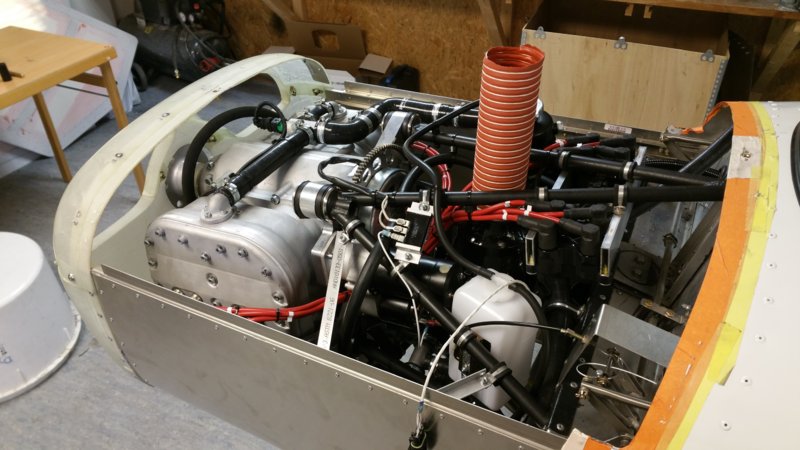

Skee Posted June 4, 2015 Posted June 4, 2015 I have one,, but im still bulding.. Number 69 Got any questions ill answer them if i can. 6 1 1
Deskpilot Posted June 5, 2015 Posted June 5, 2015 Seem that the ancillary equipment takes up more room than the engine. Neat set-up all the same. 1

Skee Posted January 31, 2016 Posted January 31, 2016 Skee,Do you have an update on your D-motor installation? I am considering a 6-cylinder D-motor for my Jabiru J230 project. Have you had any negative issues? Any reason I shouldn't consider the engine? My installation is ready for start and my two friends has already started thiers, works like a charm. (4cyl) The manufacturer has been very supportive, what is still lacking is a good users manual, he let a school do it for him in exchange for an engine long time ago, still nothing, you have to email but he responds directly same day, even on weekends. The 1 bulletin that has been issued was a change to a more powerful alternator. What works against the 6 cyl is that its still an very unproven engine compared to the 4cyl, and every aviation geek will talk about how they only trust proven engines, im so tired at that shit. So far all ok for me but i havent started it yet,

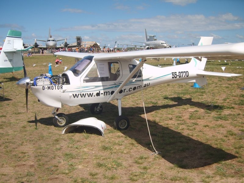

JEM Posted January 31, 2016 Posted January 31, 2016 What happened to the Jabiru (LSA55?) which was on ground display at Avalon and fitted with a D Motor? Have a photo of it somewhere. More info here See http://www.d-motor.eu/nl/jabiru-138.htm

red750 Posted March 20, 2016 Posted March 20, 2016 May not add much to the discussion, but here's a photo of the Jab that I took at Avalon. 4 1
