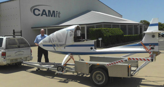

Oscar Posted May 29, 2015 Posted May 29, 2015 Russ, it's a fairly complex question. I've moved aircraft ranging from a B-25, a Canberra bomber, a couple of Sea Furies, a Mosquito, an Me262 and a Meteor, down to my own LSA55 Jab around the place. In the past 10 years I moved by road a Victa from East Sale to Brisbane and back to Morrabin; my own LSA55 I've taken to Toowoomba, Caloundra and return to near Mittagong. All with no incidents or damage. Seriously important: are you intending to trailer a J230 or a J160? The J230 horizontal stabiliser/+ elevator length will take you into 'oversize' territory. Not into requiring 'escort' ( at least in most States. but you might need to check) but signs and flashing lights etc. - and a 'wide load' permit / documentation. Next consideration: trailer load/spring rates. A Jab is fundamentally a light load for its volume; a standard car trailer will shake the crap out of one because it is designed to carry a 2-tonne plus load. Here's my set-up for an LSA55, using a modified standard 1800 x 1200 box trailer, that has a roll-bar and shock absorbers: It tows like a champ, at up to around 125khp even on bumpy roads ( the New England Highway) - but that has a fair bit to do with nearly 40 years of dragging trailers around, and when racing motor cars, at rather illegal speeds in the depth of the night. Same trailer with different fitting has towed a Victa - including a 26-foot span wing - across three States.. With wing tanks, you'll need to be able to drain the tanks before removing the wings - no biggie, just you might want to arrange storage for the unused fuel on the trailer. You may be able to use that as balancing weight for the towball download. All of the 'trailering' stuff, is solvable by a bit of thought as to trailer and fittings design. I think the more relevant stuff may be: what will you let yourself in for (reglulations and insurance-wise) regarding wing detachment / re-attachment at the new site - and if you trailer to 'B', then fly to 'C', then need to retrace to 'B' to retrieve the trailer and tow vehicle to go to 'C'? 1 1

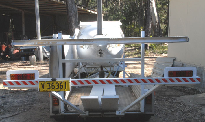

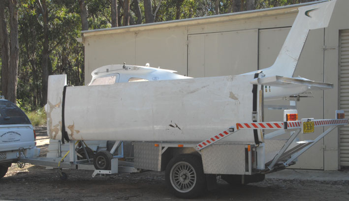

Oscar Posted May 29, 2015 Posted May 29, 2015 Russ - one I forgot: (same trailer, a better view of it): Toowoomba - Bundaberg. A lash-up, but the trailer is re-configurable.

Oscar Posted May 29, 2015 Posted May 29, 2015 Actually, it's pretty easy to do (although I did make that particular trailer specifically to be multi-purpose.) The extended drawbar is a bolt-on, with the standard trailer draw-bar having the tow-ball fitting removed and the extended bar bolted to it. That drawbar is a bit longer than ideal - iot was built to accommodate the Victa wing, with the front tip about halfway over a ute tub (takes some careful calculation so you don't get the tip banging into the tub when traversing drains etc.), but Jab wings are no problem there.. The wings are carried on bolt-in 'H' frames with ratchet straps and load spreaders on, as you can see the straps are positioned over the root and tip ribs so they don't compress the skin. The wheels sit on a cross-beam bolted under the draw-bar. Is loaded from the front by dropping off the vehicle, I can load the entire thing by myself but the LSA55 wings are very light - easily handled by one person - though not in a strong wind.. I used it without the engine in place, that adds more towball load than I'd like, because with a 6 x 4 trailer platform the mains are a fair way in front of the trailer axle; If I were doing up one for serious outback travelling, I think I'd select an 8 x 6 dual wheel platform with the springs softened right down and the wheels a bit further forward on the trailer frame - you need to get the mains reasonably close to the leading axle. On an 8 x 6 platform, I'm pretty sure you could load a J160 from the rear straight onto the platform, then it's a matter of having the front open to allow the nosewheel to sit forward, and building a 'protection +visibility frame out the back so silly buggers don't hit the tailplane, that easily bolts on once the thing is loaded (or still load from the front, which is actually easier, but you have to get the ramp configuration right....) 1
