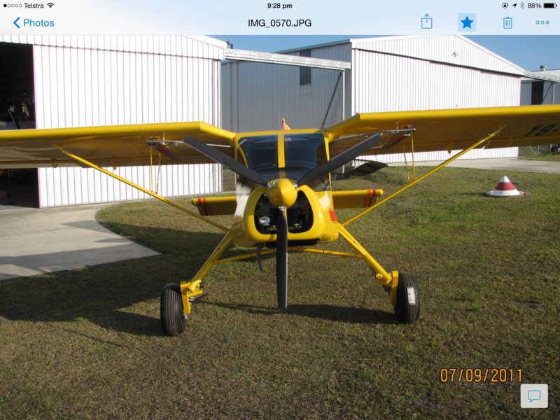

Scotty 1 Posted June 5, 2015 Posted June 5, 2015 One thing with the Hornets they are designed to run in the tropics with the open cowl so I have the oil cooler half covered all the time. Even in summer and a full power climb temp still only gets just over the 100deg mark (as the manual says) and on cruise settles back down to between 80 & 90deg. Have thought about the thermostats, but as it is, it is working ok and is one less thing to go wrong. Main reason I looked at the thermostats was to reduce the warmup to less than 5 to 6 minutes, but I don't think they reduce the time by much at all do they? 2
