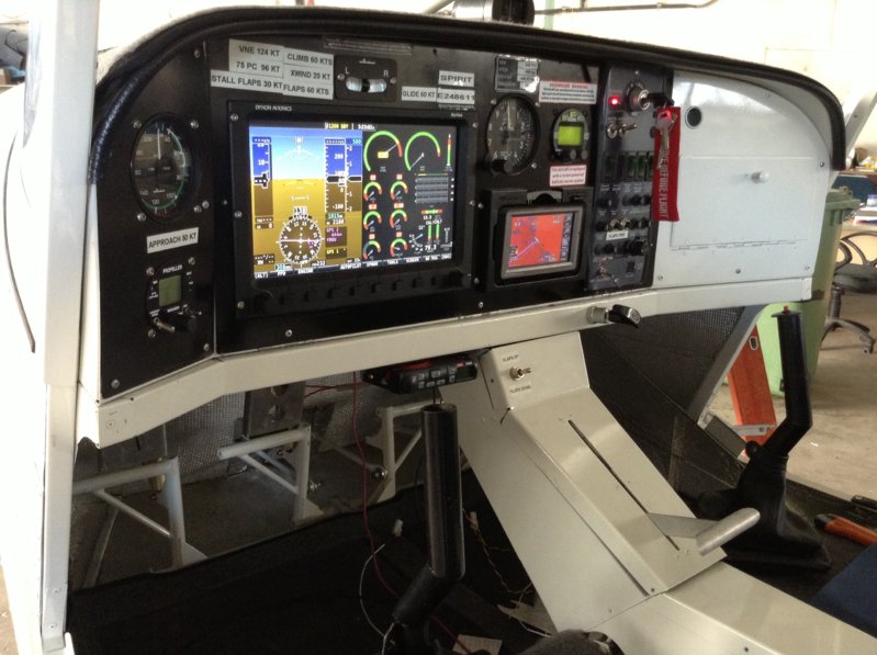

Geoff13 Posted June 15, 2015 Share Posted June 15, 2015 [ATTACH=full]36352[/ATTACH] [ATTACH=full]36350[/ATTACH] [ATTACH=full]36351[/ATTACH] I've trimmed up a lot of aircraft in my time and I feel I'm pretty good at it by now. If I have to put a fixed trim tab on anything but a rudder I consider it a failure. You should be able to achieve wings level trim on most aircraft by adjustments to either aileron or flap or a combo of the two. Rudders have to contend with a twisted airflow from the prop which often rotates around the fuselage as it travels back striking the rudder on one side only. Pretty hard to get around that one, unless your in a glider. Of course I have run into some pretty badly constructed wings also, which will cause all sorts of out of trim stuff, and are always a challange. My last trimming effort was on the WAC Spirit aircraft in the photo. During final inspection it was pretty obvious the builder had no idea where things should be, so I had to rerig the whole thing, particularly the ailerons and flaps. Bill Grieves from SE Qld performed the initial flight ( having flown a Spirit before) then conducted training in it for the owner. His comments a week later " Rarely do I find an aircraft straight out of a build that flew so nicely and almost hands off ". The Spirit by the way is the latest out of the States by World Aircraft and is sort of like a super Savannah, having much in common together with many improvements. Three kits were imported into Australia and as far as I know two have been completed and flown, with the third under construction. Unfortunately the increased price of this lovely aircraft now in the U.S. ( around $140k US) will probabily mean we don't see too many more out there in this country. Not sure which ones you know of that are flying Maj, but the one at Caboolture has been for a month or so now. Beautiful aircraft it is to. Link to comment Share on other sites More sharing options...

Kyle Communications Posted June 20, 2015 Share Posted June 20, 2015 You can't get a twist in a Savannah wing, all the holes are computer cut full size, you could build a straight wing on the front lawn. Unless of course you twist it after installation! Mine flew perfect no trimming required on any surface. Since the repair though after the nosewheel folded and the right wingtip smacked the deck the plane has got a ever so slight roll to the left when flying straight and level. It doesnt take much twist to give you a slight roll. It isnt too annoying at the moment but I will fix it. I think a half turn on the flaperon ball link will probably fix it. Link to comment Share on other sites More sharing options...
