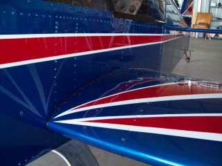

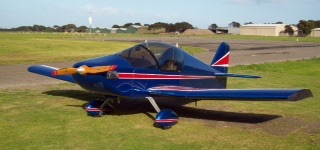

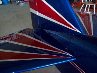

peter Posted June 18, 2015 Author Posted June 18, 2015 This is what it will be going on, paint job by Custom Aircraft Maintenance at Goolwa 4

aj_richo Posted June 18, 2015 Posted June 18, 2015 Hi Peter, Paint job is awesome!! I just made up a small data plate out of scrap stainless, about 50 x 30. Used a rotary engraver to mark with type Sonex, rego number and sonex serial number. I don't think the L4 even looked at it, just asked where it was.. under the LH horizontal stab.
