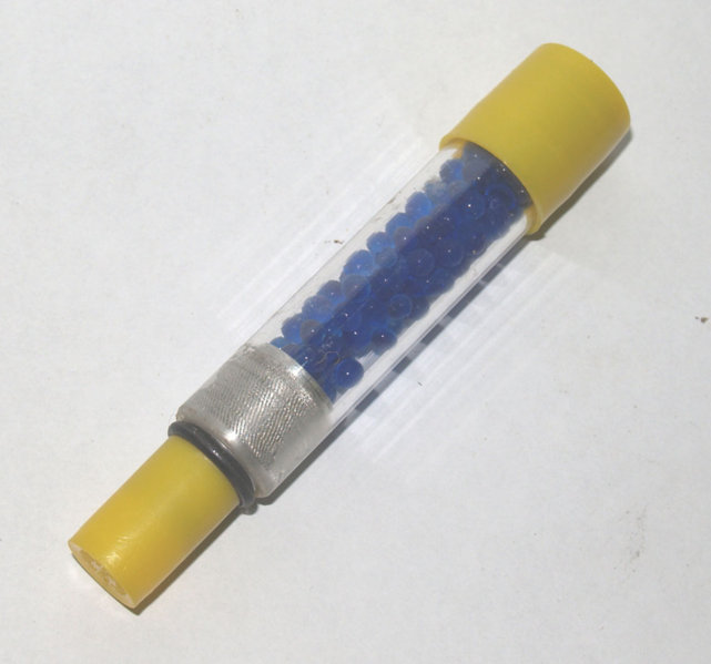

gandalph Posted June 20, 2015 Posted June 20, 2015 I'm using hygroscopic plugs ( got some made up to fit the Jab) and engine preserving oil. I'll need to go back through my records to get the name of the oil I'm using and the supplier . I'll post the details tomorrow sometime when I get to the relevant box of invoices. See post # 26 in the cylinder Bore Corrosion thread or a pic of the hygroscopic plugs I had made up. PM me for details

gandalph Posted June 20, 2015 Posted June 20, 2015 Jetjr this is the stuff I used. Got ours from Skyshop in Vic. - ASAP spares in Caboolture also carry A/C Spruce stuff, dont know if they have this though. http://www.aircraftspruce.com/catalog/eppages/vpci326.php And these are the re-useable hygroscopic plugs I had made up when I couldn't find any to fit the Jab's plug size. I had several sets made up just to use up the materials we had to buy. Happy to sell them off to re-coup some of the costs if anyone's interested. Also an article on engine preservation from Avweb that you might find useful.http://www.avweb.com/news/redundant/storing_your_airplane_for_winter_207881-1.html
