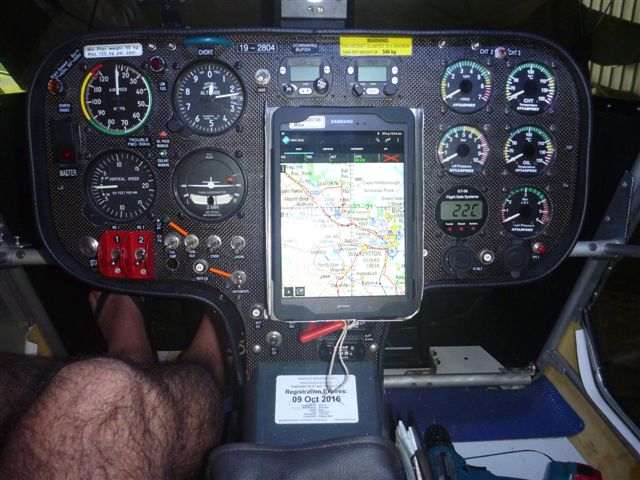

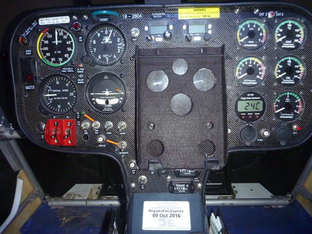

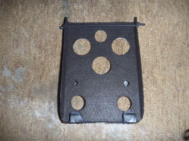

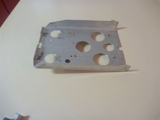

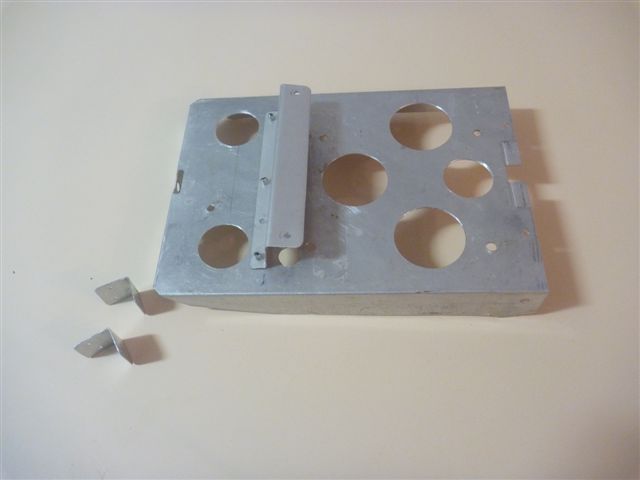

If its any help attached are the images for the mini tablet mount I made up. Two tabs at the bottom hold it in and I'm using shock cord at the top. The holder cradel is lined in sticky back felt and it will hold the tablet in its protective case and I can fit the charge / power cord from the bottom. Cheers Mike
Job finished now. The felt lining is sticky backed felt. Looking forward to the airfield dring out and getting a flight in hopefully this weekend sometime.
