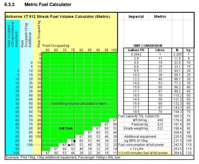

kasper Posted June 27, 2015 Posted June 27, 2015 [ATTACH=full]36544[/ATTACH] Despite this there is no such valid calculation of W&B for a weightshift. Indeed I am afraid this is another example of unknowing poor drafting on the part of the Ops manager as we moved from Ops 6 to Ops 7. Look at the old Ops 6 and the the combined requirement covered the exception for weightshift with two simple words 'if applicable'; "1.1 Complete pre and post flight administration. • Pre-flight planning and documentation is completed in accordance with regulations and/or operations manual. • Aeroplane take-off and landing performance is calculated in accordance with performance and weight and balance charts if applicable." Now when they separate the syllabus into parts for control groups in Ops 7 we lose the two critical words that used to cover weightshift ... the Ops manual is NEVER released for review to the membership or critically the CFIs and we end up with a syllabus that is patently inappropriate to ALL who learned to fly the weightshift and/or teach in them. I hazard a guess that the Ops manager is not a weightshift pilot and the inclusion was either by her in error or at the insistence of someone in CASA equally uninformed and without review from informed and knowing eyes we have an Ops Manual that in next review one hopes is corrected. And to preempt any individual posters having a go at me grasping at straws now saying its just a drafting error do a search on my posts about the quality and inconsistency within Ops 7 drafting - its basically very poor with literally dozens of inconsistencies and errors scattered throughout. You may also find through my posts the despair I feel at the coming Tech Manual which equally is being finalized without consultation and review by members and in fact the first section of the new Tech released was so fatally flawed in relation to actual operations the tech manager had to write to CASA and get the section changed to make it actually work!! 1 1

turboplanner Posted June 27, 2015 Posted June 27, 2015 Despite this there is no such valid calculation of W&B for a weightshift. Indeed I am afraid this is another example of unknowing poor drafting on the part of the Ops manager as we moved from Ops 6 to Ops 7.Look at the old Ops 6 and the the combined requirement covered the exception for weightshift with two simple words 'if applicable'; (a) It is always applicable if the POH specifies any minimum or maximum weights.* (b) RAA is simply matching CAR 235, which doesn't give RAA, HGFA, or the pilot any discretion. *The Airborne Edge XT912 Streak/Cruze for example says in 2.6.9 "Minimum Pilot Weight. The microlight aircraft must only be flown solo from the front seat. Minimum pilot weight flown solo shall not be below 55 kg. Maximum power at minimum TOW can cause an abrupt climb rate that, if uncorrected, may cause a wing attitude of greater than the placarded maximum of 45 degrees." This would be a critical calculation factor if for example a teenage pilot was about to solo. 1
skeptic36 Posted June 27, 2015 Posted June 27, 2015 (a) It is always applicable if the POH specifies any minimum or maximum weights.*(b) RAA is simply matching CAR 235, which doesn't give RAA, HGFA, or the pilot any discretion. *The Airborne Edge XT912 Streak/Cruze for example says in 2.6.9 "Minimum Pilot Weight. The microlight aircraft must only be flown solo from the front seat. Minimum pilot weight flown solo shall not be below 55 kg. Maximum power at minimum TOW can cause an abrupt climb rate that, if uncorrected, may cause a wing attitude of greater than the placarded maximum of 45 degrees." This would be a critical calculation factor if for example a teenage pilot was about to solo. Turbo, I have never seen one of these weight and balance calculations, so could you tell me what you would be expected to write on such a form. I.e I have weighed the pilot, he's 56 kg and he is sitting in the front seat iaw the poh instructions How else could you put it? Where does the calculator come in to it?
turboplanner Posted June 27, 2015 Posted June 27, 2015 The way the XT 912 chart reads, the execrcise is: (red = your input figure) Base Suspension Range: < 1245 mm Empty Weight: 223 kg Pilot: 92 kg does not exceed 100 kg, exceeds 55 kg Passenger: 70 kg does not exceed 100 kg Crew: 185 kg does not exceed 200 kg Underseat Storage: 4 kg does not exceed max Usable Fuel: 67 litres x 0.8271: 54 kg Take off Weight: 444 kg Maximum T.O. Weight: 450 kg Result: COMPLIES Part of your P&O calculations as Facthunter alluded to include fuel burn for the flight, altitude and length of landing strip, met, 45 mins reserve, and from these you set the minimum fuel for the flight. I've just given it a full tank. If the calculated take off weight exceeds the MTOW you have to start ditching items. If you need to reduce fuel, you refer to the fuel calculator (Airborne shown , which people will recognise as a classic balance envelope. If you want to carry spare fuel and camping gear, you can't just use the rear seat cushion area, floor in front of the rear seat. You have to get the passenger body CoG point from the manufacturer then back calculate your load, which may be well short of 100 kg. You will learn how to do this in W&B training. 1

kasper Posted June 28, 2015 Posted June 28, 2015 The way the XT 912 chart reads, the execrcise is: (red = your input figure)Base Suspension Range: < 1245 mm Empty Weight: 223 kg Pilot: 92 kg does not exceed 100 kg, exceeds 55 kg Passenger: 70 kg does not exceed 100 kg Crew: 185 kg does not exceed 200 kg Underseat Storage: 4 kg does not exceed max Usable Fuel: 67 litres x 0.8271: 54 kg Take off Weight: 444 kg Maximum T.O. Weight: 450 kg Result: COMPLIES Part of your P&O calculations as Facthunter alluded to include fuel burn for the flight, altitude and length of landing strip, met, 45 mins reserve, and from these you set the minimum fuel for the flight. I've just given it a full tank. If the calculated take off weight exceeds the MTOW you have to start ditching items. If you need to reduce fuel, you refer to the fuel calculator (Airborne shown , which people will recognise as a classic balance envelope. If you want to carry spare fuel and camping gear, you can't just use the rear seat cushion area, floor in front of the rear seat. You have to get the passenger body CoG point from the manufacturer then back calculate your load, which may be well short of 100 kg. You will learn how to do this in W&B training. [ATTACH=full]36558[/ATTACH] OK I am having one last go at this - everything you are looking at in the XT912 notes is a load schedule. IE weight. Now at the end of this you come up with MTOW< allowable MTOW ... every post i Ihave made states that you are only concerned with weight calcs for weighshift ... any now you just come up with a weight calc as PROOF of a weight and balance requirement. And to be very clear - the fuel calcululator is a pure payload of people trade off for pilot or passenger or underseat load - if it were a true W&B each of these would have a different station and the trade off would not be a 1-to-1 trade as the moment of 1kg of pilot would not equal the moment of 1 kg of passenger (not side by side seating here) or 1kg of underseat. Load int he XT912 is not station dependant and all areas of load are just loads, ie just weight. Now Turbs, tell me the CofG station of this 'W&B' calc in accord with the XT912 requirements ie what is the MM/CM/inches from dataum for this calc? If you can give me this information then I will gladly print out a copy of either the RAA Tech or Ops manual at your choice and eat it. Can't say fairer than that can I? Oh and if you can't will you PLEASE accept that there is NOT a weight and balance calc for weightshift. 2 1
