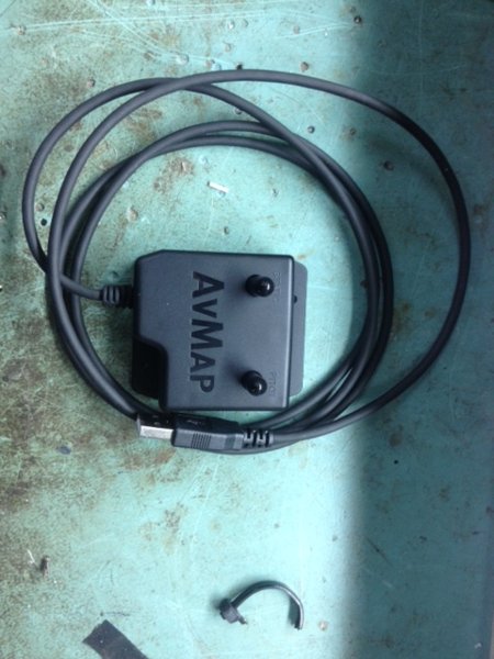

Kyle Communications Posted June 26, 2015 Posted June 26, 2015 I have 2 of the Xtreme EFIS but one is just used on the engine but of course can be a backup EFIS. I just scored a AHRS module for my EKP-V this week. One of the aircraft parts wholesales put out a end of year flyer and they had 1 only of them for around 1/4 of the normal price so I picked it up and will install it this weekend while I am replacing my dash. You need the dash mount to do it with the EKP-V to be able to fit it and i have the mount so its just a USB lead plug in to the dash mount. Mark
Ultralights Posted June 26, 2015 Author Posted June 26, 2015 can you mount the AHRS module for the EKP remotely?
Kyle Communications Posted June 27, 2015 Posted June 27, 2015 Yes it has about 1.8 mtrs of cable with a USB plug on the end. So if you needed to mount it further away you can just use a USB extension cable as the dash mount has about 4 USB sockets in the back of it. One is for the remote GPS antenna as well 1
