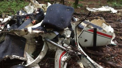

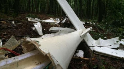

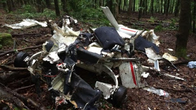

I agree that time will probably tell Ross, I just had a look at a translation of the Holzminden Jab crash, on a news type site with some comments afterwards which mentions the possibility of the aircraft striking several treetops before impacting the forest floor. This does not mean that it definitely Didn't break up in flight, as the investigation is ongoing but THEIR speculative comments released to the media based upon what evidence they have seen thus far suggests CFIT in very poor visibility. The wreckage trail was quite extensive.
It will be interesting to read the final report. 1715900593_Jabcrash1.jpg.6dbfe15a4fb2a1bb2ef61d973fd52581.jpg
