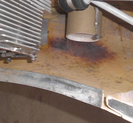

jetjr Posted July 26, 2015 Posted July 26, 2015 Yep mine has the same marks Interestingly where the tailpipe sits resting on the cowl theres nothing I have stuck on some heat proof insulation but thats PPE i guess Have you lookd at CAE new muffler design? Should get rid of plenty of heat if it can fit. Another story, my heater hose somehow came off, lodged on top of muffler, pretty much pointing at floor under pilot feet. the incoming forced air jetted past muffler, caused burning of outer glass and core of the floor. Nasty black charred hole around 50mm accross. Luckily i smelt and felt a problem and retuned to land. Was only doing test circut thank goodness. Had it burnt through much further an extinguisher would have been very helpful

Oscar Posted July 26, 2015 Posted July 26, 2015 Yep mine has the same marksInterestingly where the tailpipe sits resting on the cowl theres nothing I have stuck on some heat proof insulation but thats PPE i guess Have you lookd at CAE new muffler design? Should get rid of plenty of heat if it can fit. Another story, my heater hose somehow came off, lodged on top of muffler, pretty much pointing at floor under pilot feet. the incoming forced air jetted past muffler, caused burning of outer glass and core of the floor. Nasty black charred hole around 50mm accross. Luckily i smelt and felt a problem and retuned to land. Was only doing test circut thank goodness. Had it burnt through much further an extinguisher would have been very helpful Wow... if I were running 'Oscar's Flameproof Knickers Co', I'd use that story as a 'testimonial'.. The scorch marks on the cowl are a warning sign; as an aero engineer has told me, part of the 'fireproofing' for 'glass comes from the 'paper-bag full of water vs. flame' effect - where the cooling on one side (airflow) keeps the temperature on the other side from igniting the material. Our cowls have coremat in them, which is quite a good insulator, so we rely to a considerable degree on the presence of Aluminum Trihydroxide in the resin - but eventually that loses its water-releasing property and can no longer cool the resin/glass matrix. I intend to research, for my own cowl manufacture, the addition of an internal layer of a ceramic, heat-reflective and fire-retardant paint. I will be running some tests on that on a sample coupon of A-H containing lc3600 to see if it improves flame resistance - I'll pass the results on when I have done those. 1
