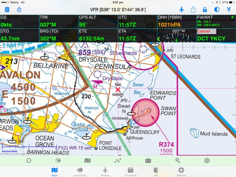

skeptic36 Posted July 5, 2015 Posted July 5, 2015 Hi all, I need some help adding a custom waypoint to a flight plan in Oz Runways. I don't understand how the coordinates should be written correctly. A guy has sent me a set of coords that are supposed to be on the west side of Port Phillip bay, this is what he sent: That didn't appear to be the way coordinates are presented in Ozrunways, and I eventually got it to accept them like this: Problem is that isn't where I want to go. What's wrong? Be gentle with me, I'm not very smart

Geoff13 Posted July 5, 2015 Posted July 5, 2015 I am not certain of this but I think you need to convert to degrees and minutes with a decimal for the seconds. Should possibly read 38 degrees 13.1 minutes South and 144 degrees 38.9 minutes east. Shown here as test custom.
skeptic36 Posted July 5, 2015 Author Posted July 5, 2015 Thanks Geoff, That's about where I want to go, my last effort was sending me 6000 nm somewhere lol Thanks again Regards Bill

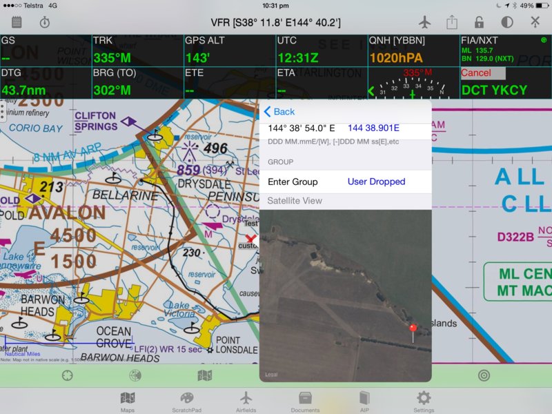

Geoff13 Posted July 5, 2015 Posted July 5, 2015 Once you enter your coords and put your user waypoint in, then tap on it and scroll down, you can see how close I got to what you where looking for
Geoff13 Posted July 5, 2015 Posted July 5, 2015 If you turn curser on in Oz runways then you can read the coords at the top of the page for the curser position. Zoom in to get more accurate. When you are on the spot just tap it and go set user way point. That will put it right on the curser. To turn curser on just tap small gear and then show curser.
