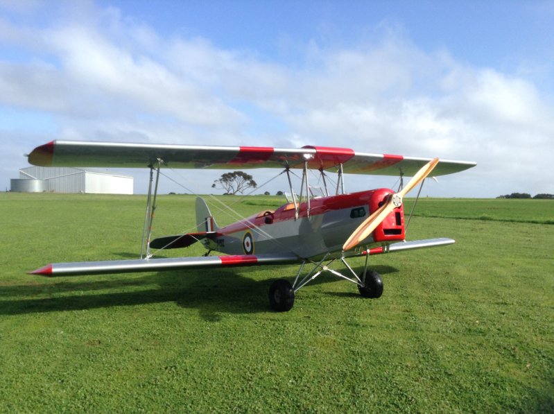

Rodr Posted July 9, 2015 Posted July 9, 2015 anyone know of a spinner manufacturer in Aus that could build a small spinner for a wooden prop on a Rotax suitable for a replica tiger moth? 1

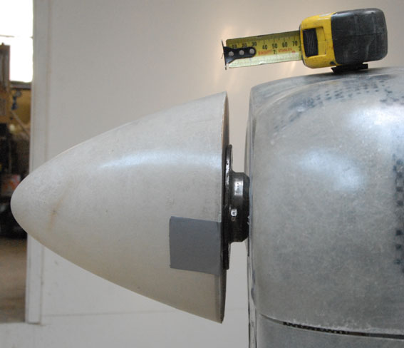

Oscar Posted July 9, 2015 Posted July 9, 2015 What base diameter are you looking for? I have a mould for a spinner of around 200mm base diameter - here's a piccy of a trial mould of it I made recently for my own project: 1
Rodr Posted July 9, 2015 Author Posted July 9, 2015 Thanks Oscar the diam needed is around 130mm or 5inches any larger would look odd as the moth spinner is traditionally very small like a nipple on a tit! I would place a picture of the prop here but unsure of how to do it!!! Cheers
Oscar Posted July 9, 2015 Posted July 9, 2015 Bloody heck - that's not a spinner, that a proctologist's thimble..

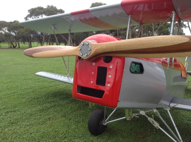

Rodr Posted July 9, 2015 Author Posted July 9, 2015 Ok this is the foundation for thr nipple on the tit! 1

Rodr Posted December 13, 2015 Author Posted December 13, 2015 From Univar aircraft corp USA part no U0450279 check out there site lots of small spinners for Cessna This was just called " small Cessna spinner" Cheers

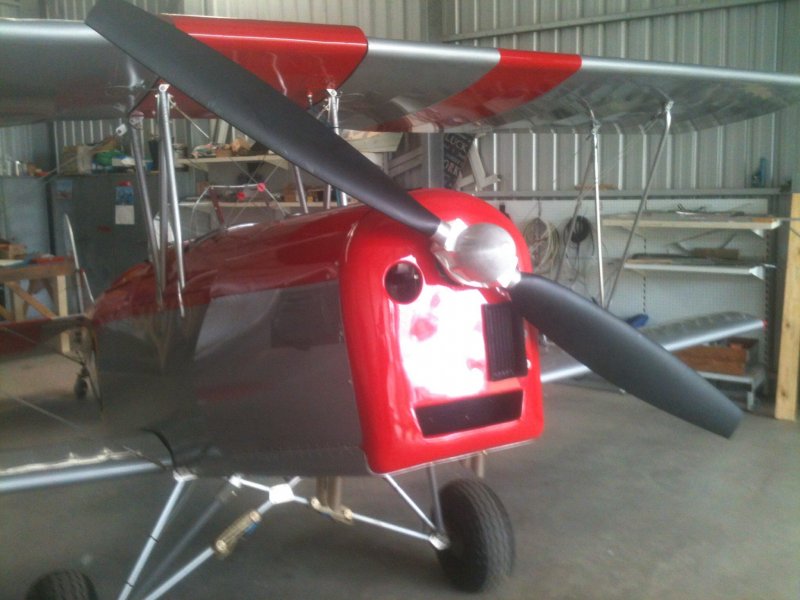

Rodr Posted December 16, 2015 Author Posted December 16, 2015 Rodr, that is a beautiful aeroplane. I gather you built it - which kit was it? Or did you build from plans? Well done!Nick, great tip for spinner balance. I'm going to grab the wife's laundry bucket tomorrow. . . Bruce Built from a Fisher kit R-80 tiger moth replica have just completed the 25hrs testing all good changed prop from the wood 76" to a composite ground adjustable 74" made a hellava diff in performance now 70kts at 5200rpm Rotax 912uls.
pylon500 Posted December 17, 2015 Posted December 17, 2015 Would be nice to measure the Warp prop, once sorted, and carve a new wood to that setting, just to add to the scale look.
