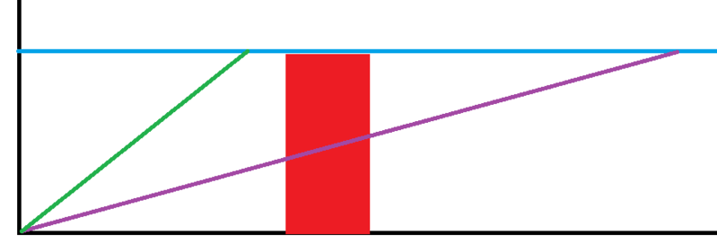

NljbA380 Posted July 11, 2015 Author Posted July 11, 2015 I think im just going to have to accept it for what it is at this stage. For some reason i just cant grasp it. If there doing it at the same speeds, the best angle of climb will have a higher attitude, will cover less ground distance, but reach the same height. Where as the best rate of climb will have a lower nose attitude, and cover more horizontal distance, which would be better for fuel encomy. Where as the best rate would be more appropriate for takes off where there are obstacles at the end of the runway. So generally speaking, is it preferred to use a best rate of climb, since your covering more ground distance which would be mean you going to save time (fuel) and because you have better visibility because of the lower nose attitude. I just dont understand how they can be the same altitude after the one min, and not have different speeds. If they had different speeds, that would make sense, what is the difference between them. Sorry if im being a pain.

planesmaker Posted July 11, 2015 Posted July 11, 2015 Quote I think im just going to have to accept it for what it is at this stage. For some reason i just cant grasp it.If there doing it at the same speeds, the best angle of climb will have a higher attitude, will cover less ground distance, but reach the same height. Where as the best rate of climb will have a lower nose attitude, and cover more horizontal distance, which would be better for fuel encomy. Where as the best rate would be more appropriate for takes off where there are obstacles at the end of the runway. So generally speaking, is it preferred to use a best rate of climb, since your covering more ground distance which would be mean you going to save time (fuel) and because you have better visibility because of the lower nose attitude. I just dont understand how they can be the same altitude after the one min, and not have different speeds. If they had different speeds, that would make sense, what is the difference between them. Sorry if im being a pain. I think you have mixed the terminology and confused yourself. Best angle of climb is done usually at a lower airspeed but higher angle of attack( nose high) to clear obstacles but gives a lower rate of climb eg500ft/min which may only result in 1.5kms to arrive at 1000ft but take 2 mins. this is used to clear obstacles. Best rate is done at higher airspeed & will give you altitude faster but over a greater distance on the ground eg 700ft/min& 2 km to get to 1000ft(about 1.5 mins ) just as an example So best angle is in relation to the ground, best rate in relation to time.
NljbA380 Posted July 11, 2015 Author Posted July 11, 2015 Quote I think you have mixed the terminology and confused yourself.Best angle of climb is done usually at a lower airspeed but higher angle of attack( nose high) to clear obstacles but gives a lower rate of climb eg500ft/min which may only result in 1.5kms to arrive at 1000ft but take 2 mins. this is used to clear obstacles. Best rate is done at higher airspeed & will give you altitude faster but over a greater distance on the ground eg 700ft/min& 2 km to get to 1000ft(about 1.5 mins ) just as an example So best angle is in relation to the ground, best rate in relation to time. Haha, yes. I have indeed. Its just i asked if the airspeeds differ before and was told they dont. which is what confused me even more. But i referred back to my book again, and basically its saying for one minute of time, a best angle of climb will produce x altitude gain, over a smaller horizontal distance, at a steep angle of attack with a higher attitude and because of this a lower speed. Where as a best rate of climb will produce a climb that is at a lower angle of attack and hence a lower attitude, will cover more horizontal distance, and will reach the similar altitude in the same time because it is doing so at a higher speed. If they were to complete both these two climbs, at the same speed and the same time interval, the best angle of climb would clearly gain a larger amount in altitude Correct?
planesmaker Posted July 11, 2015 Posted July 11, 2015 No. If you climb best angle may only give for example 500ft/min take 2 mins to 1000ft whereas best rate will yield say 700ft/min and only take 1.5 mins to 1000ft but cover a greater distance. Usually used where you are doing a nav and want to climb to say 5500ft and cruise, so it will get you to altitude faster and cover the distance faster( both desirable) Best angle usually only used to clear an obstacle and usually only used for as short a time as possible (cooling, visibility etc) Best angle maybe at 60kts best rate maybe at 80kts just as an example 1
Happyflyer Posted July 11, 2015 Posted July 11, 2015 Quote If they were to complete both these two climbs, at the same speed and the same time interval, the best angle of climb would clearly gain a larger amount in altitude Correct? Remember the only difference between flying at best rate and best angle is the air speed, so you can't do the two climbs at the same speed. Your aircraft flight manual gives you the one and only speed you fly for best rate and the one and only speed you fly for best angle (which will be lower than best rate).
