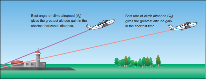

Aldo Posted July 12, 2015 Posted July 12, 2015 Can somebody explain NljbA380 Vx vs Vy have a look athe pictorial attached it is that simple To help remember which is which, I imagine a chart where the x-axis is distance, and the y-axis is altitude. If distance (x) is a concern, then use Vx to minimize the x value for a given y. If reaching a given altitude (y) quickly is your primary concern, then use Vy. If you are concerned about looking after your engine (and you should be) climb at the fastest speed which gives you a reasonable rate of climb. Also, can someone please explain the stalling angle of attack/speed "The angle of attack is the angle at which the wing meets the air." An aerodynamic stall (wing) is only dependent on the angle of the relative airflow to the leading edge (keeping it simple) it is not dependent on speed an aerodynamic stall can happen at any speed and any nose position (aircraft attitude) e.g. you can stall pulling out of a high speed, low nose attitude, low power dive or in a slow speed, high power high nose attitude climb. Aldo

ben87r Posted July 12, 2015 Posted July 12, 2015 Just with the picture above, although good, should show the AC that uses VY above the one using VX, as it would be if represented by a period of time. I found a few like that when training and found it added to the confusion. 2
