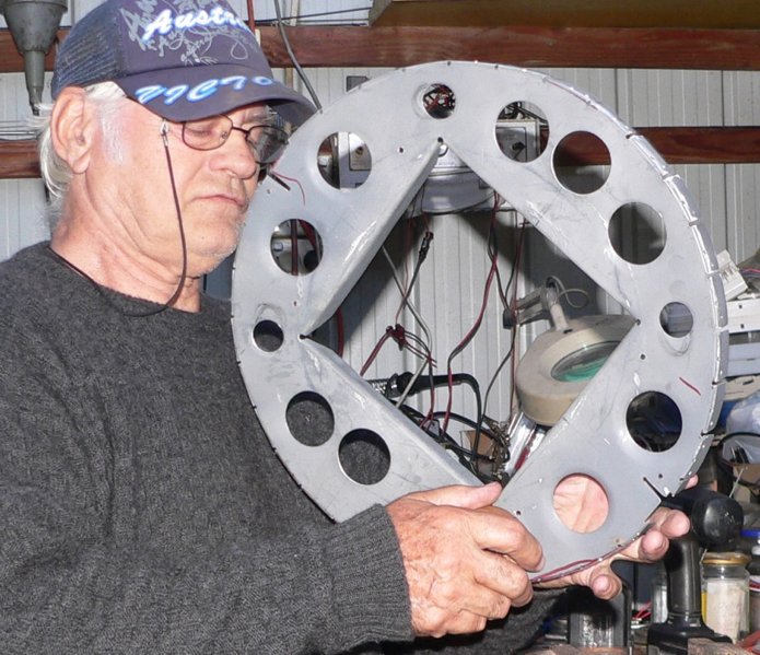

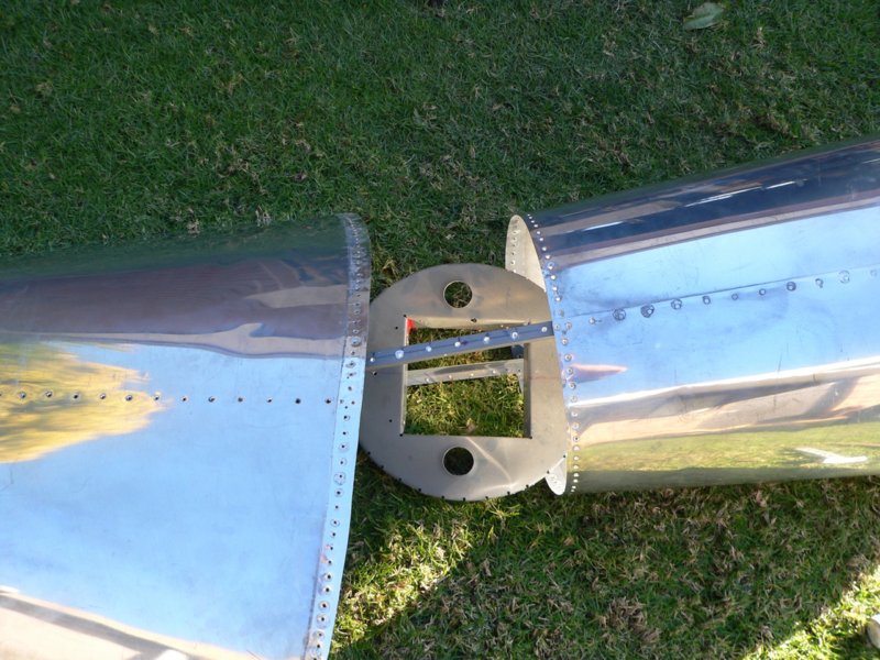

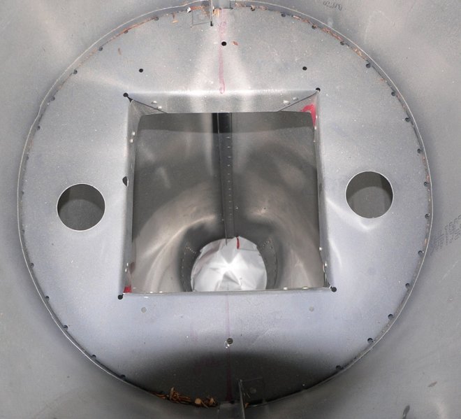

Now back to unbuilding the hummelbird, only a few thousand rivets to drill out.
