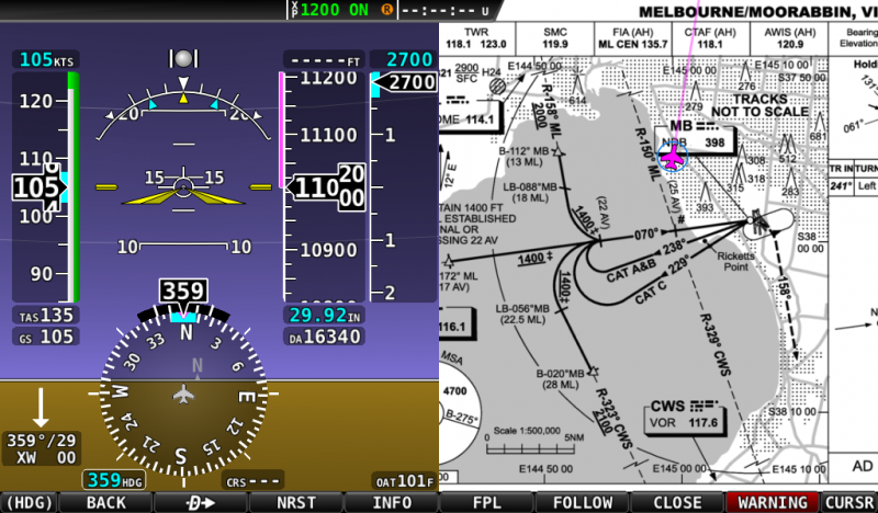

Bevan Posted August 10, 2015 Posted August 10, 2015 Here is what the geo-referenced DAP's (including airport diagrams) look like in the Skyview
