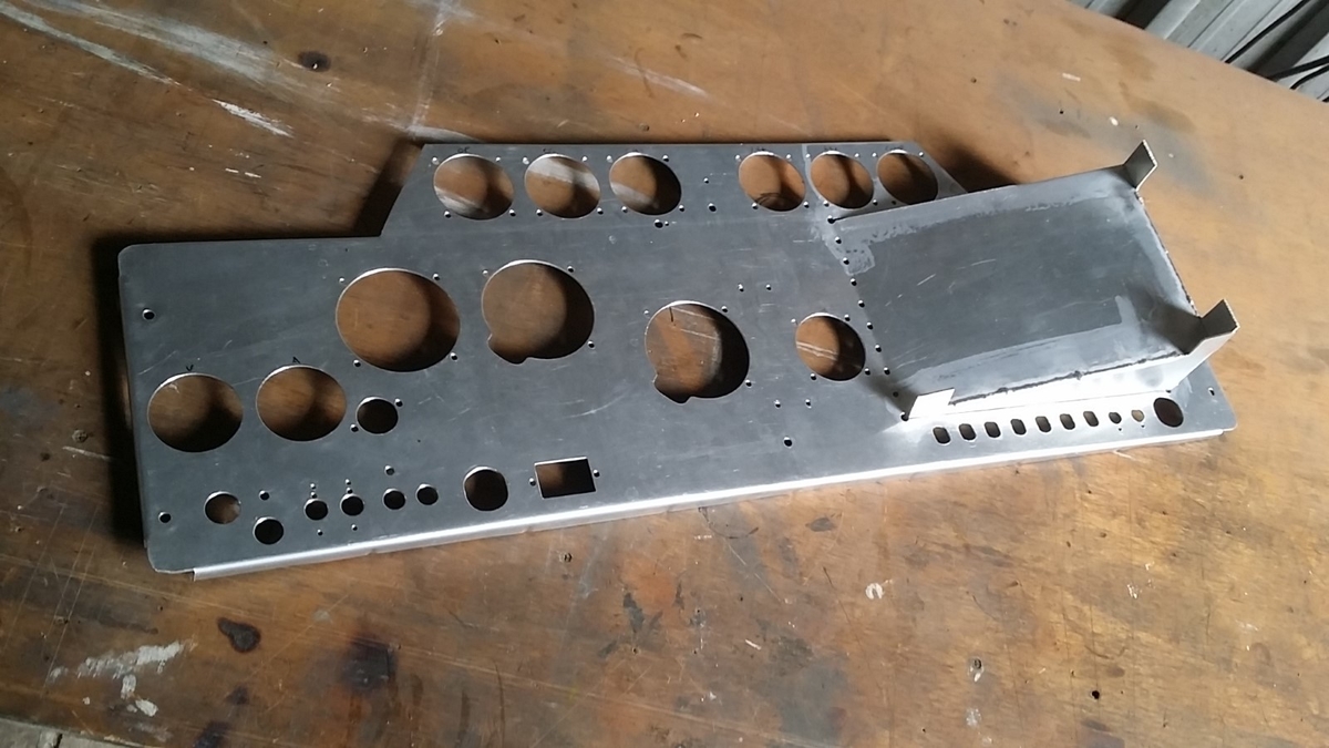

Head in the clouds Posted December 7, 2018 Author Posted December 7, 2018 So - ten weeks ago I said I was back on the case, then I found that I simply couldn't do another thing at all because every square inch of the workbench was piled high with 'stuff', mostly bits and pieces left over and not sorted and put away from previously completed or partially completed parts of the project. I started to make the instrument panel and drove myself mad because every time I put anything down I lost it among the other detritus on the bench, or I didn't have room to set up a jig or a hand-rest. Consequently I embarked on a 'quick' clean-up, but I have this problem, with me it's all or nothing, so I ended up searching the net and travelling far and wide to get hold of as many steel 'Brownbuilt' style cabinets as I could ... oh, I forgot to mention we had a minor rodent plague here as well and they crapped all over the work I'd been doing and chewed some wiring and other bits I had to re-do so I also spent long hours buying and testing the whole gamut of rodent annihilation devices. For anyone who's curious - they all work but though some are better than others, you need all of them if you want to win. We don't use poisons here because we have 4-500 birds that gather daily to amuse my good wife, and some of them would eat a dead or sick mouse and die as a result, and because of the birds and the occasional mouse we also have a number of friendly pythons and they might suffer a similar fate, and neither would I wish a nasty end on the two large eastern browns hanging here looking for a free feed, even the one which took a swipe at me a couple of weeks ago ... so it's all about trying to trap the wily (rodent) baskets - the ones the pythons and browns and kookaburras don't get, that is. Best result so far has been with the 9000V rodent zapper, though any roach will also trigger it and it's therefore harmless until reset in the morning - the magpies love the zapped roaches. The Nooski seems like a lovely and easy trap concept but with two of them and three months has only produced one casualty so far. Snap traps are a waste of time here, the rodents' great grandparents have told millennium mouse all about how to raid them unscathed, and the self resetting box trap that will catch 'up to ten mice at a time' for release or drowning, hasn't caught anything except a very apologetic cane toad who had an irresistible urge to sample cat biscuits and dried baitfish. The winner? The walk the plank and fall in a bucket thing. In the meantime I've been itching for much more flying the lovely little Kestrel. I've done lots of maintenance and replacing worn out things on it and it gets better and better, a few flights back I came home each time trailing long lengthens of gap strip (the fabric strips that close the gap between the wing trailing edge and the ailerons). It looked like a fair bit of hassle to replace them but I couldn't ignore the itch so ordered new fabric and the adhesive tapes and stitched them up and cleaned off the old adhesive and finally got it done - and wow, well I'd almost convinced myself it wasn't worth worrying about because the ailerons were so sluggish anyway ... but now the roll rate rivals anything I've flown, so I'm delighted. BUT - since then the weather has been totally crappy for weeks. Okay, next post I'll tell something about the progress on DooMaw. 2 1
