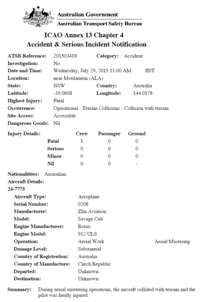

David Isaac Posted July 31, 2015 Posted July 31, 2015 Asmol, Pretty much confirms mustering. My info was that it was Bill's first flight in the aircraft. Either way he only just acquired the aircraft. Whether he was endorsed or not for mustering is now a moot point. A terrible penalty to pay.

turboplanner Posted July 31, 2015 Posted July 31, 2015 Yes the ATSB report confirms aerial mustering. Interesting that ATSB is on the case as well as RAA.

Guest asmol Posted July 31, 2015 Posted July 31, 2015 I asked the usual peps at the airport who knows the previous owner who is also an instructor. The pilot had 3,500 plus hours, all reports were a very capable, experienced and safe pilot. He didn't have a mustering (low level) endorsement and had less than 3 hours in the plane including his checkout. There were witnesses on the ground assisting with the 'mustering' and reported he was 90 degrees bank, really slow and banked over all the way and dove straight in. Sorry to bring you the bad news. Also if you look at the ATSB report it says they are only reporting, not investigating.
David Isaac Posted July 31, 2015 Posted July 31, 2015 Classic low level stall and impact. Shouldn't be anywhere near 90 degrees at low level. Classic gotcha that he would have been taught about in a low level endo. It is very sad that he had to pay the ultimate penalty 2

turboplanner Posted July 31, 2015 Posted July 31, 2015 I think I described my conversion from GA to RA as "standing up in a canoe" - a major difference in skills required compared to a high speed cruising aircraft, the differences primarily being aeronautical knowledge rather than which lever to pull and push. Interesting to know who his RA instructor was.

facthunter Posted July 31, 2015 Posted July 31, 2015 The laws of physics applies to all equally, regardless of hours flown. A 90 degree bank requires infinite lift if it is balanced. You can't sustain a 90 degree bank. Nev

Head in the clouds Posted July 31, 2015 Posted July 31, 2015 Quote ... I can't imagine how he would have thought such a extreme bank angle could result in anything else but disaster when close to the ground .... It's a really easy trap to fall into when flying ground-related airwork. Extreme bank angles happen for several reasons, it can be wind drifting you over the target while manoeuvring or the mob moving under you, the tendency is to increase your bank angle to be able to keep your eye on the target. While you're watching the mob instead of the horizon, the high bank angle results in the nose dropping, by the time you look up and notice you think you have to reef back and consequently stall. Correct recovery if as for a spiral dive - roll level before raising the nose. Trying to communicate with ground crew by hand signals etc (i.e. without radios) is another trap that can have similar results. Both of these scenarios are part of LL/mustering curricula. The real issue is that there's rarely any need to fly low when mustering except when yarding cattle without ground support, and that's helicopter territory. That's why there's a mustering training course and endorsement ... 2 1 2
