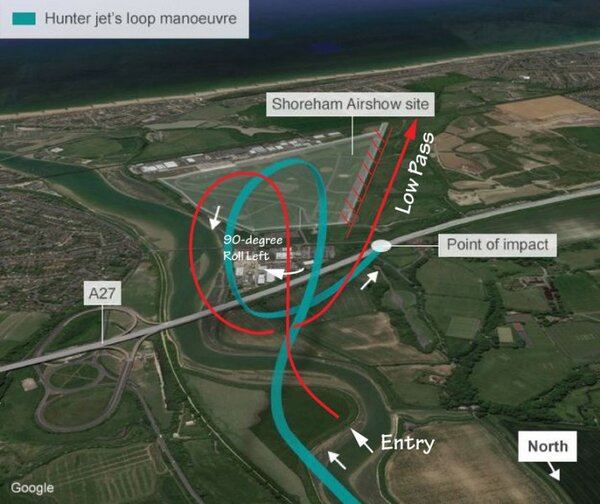

Guest ozzie Posted September 5, 2015 Posted September 5, 2015 This morning Sunrise news reported that a prelim report stated that the pilot entered the loop some 200ft lower than the required height needed for safe completion.

Phil Perry Posted September 5, 2015 Posted September 5, 2015 This morning Sunrise news reported that a prelim report stated that the pilot entered the loop some 200ft lower than the required height needed for safe completion. If this turns out to be the case, Ozzie,. . . then this particular pilot has singlehandedly removed the "Gold Standard" which the UK had held for a number of decades as the safest place to witness an Air Show. . . . . . We shall not know until all the figures are in,. and he has been interviewed by AAIB people. We keep getting snippets, but all this stuff does is create supposition and speculation. . . .if it DOES turn out to be Pilot Error for whatever reason,. . .then that is what will be reported, in enormous clinical detail. We've heard ALL SORTS of opinions ( here in the UK ) from supposed "Experts" as to what caused this tragedy,. . .and at the end of the day, we really now have to wait to see what the AAIB people report at the end of it all,. . .after all, they have been proven to be a very good bunch of aviation scientists, with every bit of technical equipment available to them. . . . and take no crap from external influences in finalising their reports,( They often get this from foreign governments where they are asked to assist in an investigation ) wherever this is realistically and technically possible. They have a wealth of individual video footage of the entire event, as it unfolded, something denied by a lack of today's technology to the crews of the two aircraft commanders who allowed themselves and their passengers to collide with each other over the Grand Canyon many years ago ( On TV last night ) with devastating results. . . . . Let's wait and see. Kind regards, Phil
Teckair Posted September 6, 2015 Posted September 6, 2015 This morning Sunrise news reported that a prelim report stated that the pilot entered the loop some 200ft lower than the required height needed for safe completion. Actually I thought they said last night he entered the loop at 200ft when it should have been 500ft.
Deskpilot Posted September 6, 2015 Posted September 6, 2015 It doesn't matter at what height you enter a loop. The important thing is to what height you climb before going over the top. Climbing to that correct height is dependent on the power/speed you have at the time. 1

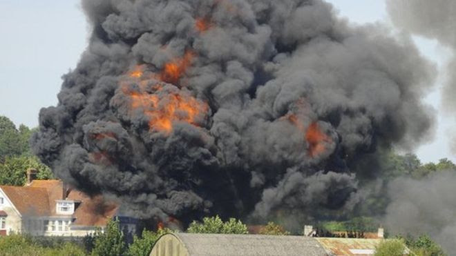

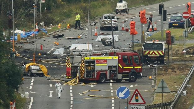

old man emu Posted September 6, 2015 Posted September 6, 2015 Phil sent this through to me: 'No abnormalities' with Shoreham jet, interim report finds Image copyright eddie mitchell Image caption Eleven people died in the crash on the A27 in Shoreham last month The jet which crashed at the Shoreham air show killing 11 people showed "no abnormal indications" during its flight, an initial report has found. The Air Accidents Investigation Branch (AAIB) report said cockpit footage showed the plane "responding to the pilot's control inputs". It also said pilot Andy Hill was thrown clear of the aircraft during the later part of the crash on 22 August. The AAIB said it was not clear whether Mr Hill initiated his ejection. The 51-year-old pilot is currently in a serious but stable condition in hospital. The report says the Hawker Hunter's canopy was released at the initial impact. At this time fuel and fuel vapour was released and then ignited. The jet split into four parts and both Mr Hill and his seat were thrown clear off the cockpit. The report states: "The investigation continues to determine if the pilot attempted to initiate ejection or if the canopy and pilot's seat were liberated as a result of impact damage to the cockpit." Image copyrightReuters Image caption The crash site was littered with wreckage from the jet. The AAIB's report also revealed there was no "blackbox" flight recorder on the vintage jet, however, there were two cameras positioned in the cockpit. It revealed: "To date, no abnormal indications have been identified [from the footage]. "Throughout the flight, the aircraft appeared to be responding to the pilot's control inputs." The AAIB said it has received a "large amount" of video footage and photographs of the aircraft, many of which were taken in high resolution, from a variety of locations on and around Shoreham Airport. It said an analysis of the still and moving images using "photogrammetry techniques" will be undertaken to establish the parameters of the aircraft's manoeuvres, including flight path and speed. OME
Teckair Posted September 6, 2015 Posted September 6, 2015 It doesn't matter at what height you enter a loop. The important thing is to what height you climb before going over the top. Climbing to that correct height is dependent on the power/speed you have at the time. If you have insufficient power / speed to climb high enough to go over the top then it does matter. 1
flyvulcan Posted September 6, 2015 Posted September 6, 2015 An air show performer will generally have his display designed around a series of "gates". The gates are normally established for entry, during and exit from manoeuvres and generally consist of location/altitude/speed/bank angle etc. targets which if not achieved will result in a "knock it off". The "knock it off" recovery will also be preplanned. A looping manoeuvre such as the one flown at Shoreham would normally have had a gate going over the top of the loop which would have included a minimum altitude and a speed range. The pilot would check this gate going over the top (indeed he would be anticipating it on the upside of the loop and relax the g a bit if he could see that he was not likely to achieve the minimum altitude at the apex for example). If at the apex of the loop the gate was not achieved then the pilot would bug out of the manoeuvre (generally roll right side up) then re-establish the routine to achieve the gate for the next manoeuvre. The routine and gates would be established such that if there was an event, such as a loss of power, that a recovery to controlled flight would be possible. This is why the STOL aircraft hanging on its prop at 100' above the runway at minimum speed is not smart. A loss of power from this flight regime would result in an uncontrolled crash. If done at 500', a loss of power could give the pilot a reasonable measure of control into the ensuing impact with terrain. In an accident such as the one at Shoreham, there could have been any number of factors contributing to the accident; failure to achieve a gate, failure to fly the required profile accurately, systems failure of the aircraft, environmental factors (bird strike etc.) etc.. With the availability of information about this accident, I anticipate that the AAIB will be able to fairly accurately determine what factors contributed to this tragedy. 2
facthunter Posted September 6, 2015 Posted September 6, 2015 You can loop a glider easily enough and it's an energy thing. Often you enter a loop after building up speed in a dive if the plane is draggy and underpowered (like a DH 82) . nev 1
