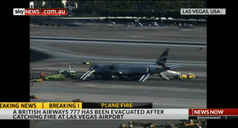

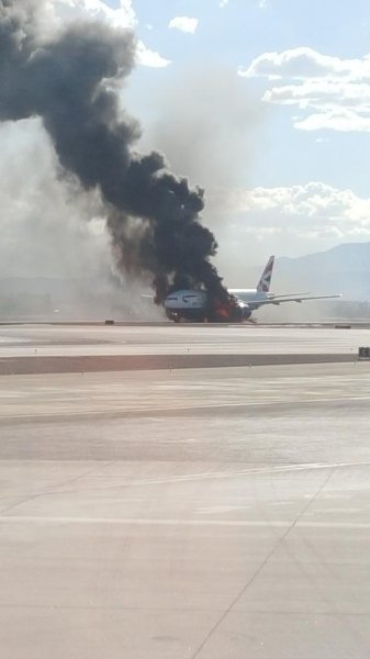

red750 Posted September 9, 2015 Posted September 9, 2015 A British Airways Boeing 777 was evacuated at LAX when the aircraft caught fire - Sky News.
dutchroll Posted September 9, 2015 Posted September 9, 2015 Left engine fire on takeoff, rejected takeoff, evacuation. Back to pub. Suspend alcohol-free fitness regime. Do paperwork later. 1 1

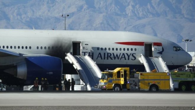

facthunter Posted September 9, 2015 Posted September 9, 2015 I would be interested as to the exact cause, and why would you open the front LH door? Nev
Guest Maj Millard Posted September 9, 2015 Posted September 9, 2015 It would be some decision to activate the chutes with an active fire like that.......should make for good watching on air crash at some stage in the future.
dutchroll Posted September 9, 2015 Posted September 9, 2015 Why the front LH door? In a ground scenario, once the Captain orders the general evacuation over the PA all the flight attendants go into "automatic" mode. A ground evac is only carried out on orders from the flight deck. Different for a ditching, because it's rather obvious. The door primaries (individual flight attendants allocated primary duty at each door) are trained to open their respective door if the exit path appears clear through the door window. So as long as that path straight out from the door is free of smoke and flames, that door gets opened. It certainly appears to be the case in the photos that the Left 1 door escape path is clear. While the slide is inflating, the door primary is bracing themselves across the door using the handholds either side, and getting a better view of the escape path and checking the slide inflates properly before they stand back out of the way next to the door opening, and start yelling at people to jump and thankyou for flying with us, have a nice day. At any point, the door primary can decide the situation around the escape slide is getting too dicey and declare a "blocked exit" and start shoving people across to join in the queue for the opposite door, or send them forward or backward depending on the flow. But as long as that escape path stays clear at L1, which it seems to have despite the smoke and flames 10 metres away, I would not expect them to do that. You will note that door L2 (left 2, just in front of the engine) stayed closed. That hostie deserves a big pat on the back. Obviously checked through the window, went "oh sh*t", and kept it closed while redirecting passengers across, forward, or backward to the other doors. 1 1 3
Roundsounds Posted September 9, 2015 Posted September 9, 2015 That hostie deserves a big pat on the back. Obviously checked through the window, went "oh sh*t", and kept it closed while redirecting passengers across, forward, or backward to the other doors. I reckon this will feature in your annual visits to building 148 in a year or so. It's interesting the rear right slide didn't deploy for approx 15 secs after those on the right. 1

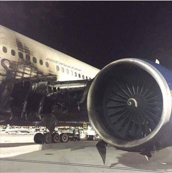

ben87r Posted September 9, 2015 Posted September 9, 2015 I herd the ATC recordings, seemed very professional, and well executed.. Someone should shout their beers Ild reckon. One of the photos I saw showed an un-contained failure. 1
Downunder Posted September 9, 2015 Posted September 9, 2015 Not all beer and skittles.... http://www.msn.com/en-au/news/world/british-airways-plane-catches-fire-on-las-vegas-runway/ar-AAe5FYv "Initially told to stay seated, then shout of evacuate," he said, adding that the flames had apparently melted some of the jet's windows. "They opened the back door and slide went down and smoke started coming in plane, followed by mad dash to front. A lot of panic," he said.
dutchroll Posted September 9, 2015 Posted September 9, 2015 The result of a "less than ideally contained" engine failure. Have a close look at the engine cowling and its shadow on the ground (there are no bits poking out of a normal jet engine cowling!). 1 1 1

dutchroll Posted September 10, 2015 Posted September 10, 2015 I have no doubt whatsoever that the crew left all their luggage on board. During an evacuation the crew have a lot more things to think about and do than grab their bags. so the fuel tank is inline with the engine in a 777? A lot of the wing is fuel tank. If you think about where the turbine section of a modern pod-mount jet engine is, and that an uncontained failure at takeoff thrust spits 800 deg C shards of that section outwards radially in pretty random directions, some of it is quite possibly going to severe or puncture something carrying a flammable liquid or vapour. 1

dutchroll Posted September 10, 2015 Posted September 10, 2015 There seem to be a few news reports quoting "90 mph" or thereabouts, though it's not clear where those figures came from. That would make it a relatively low-ish speed abort, but I'd be interested to know if it was fast enough for the autobrakes to be armed. Amendment to my last about the hot end too - it looks like the failure was in the high pressure stages of the compressor, rather than the turbine. But that's still pretty hot. Several 7-8 inch long fragments of the compressor spool were recovered from the runway. Source (on the engine information): NTSB press release.
