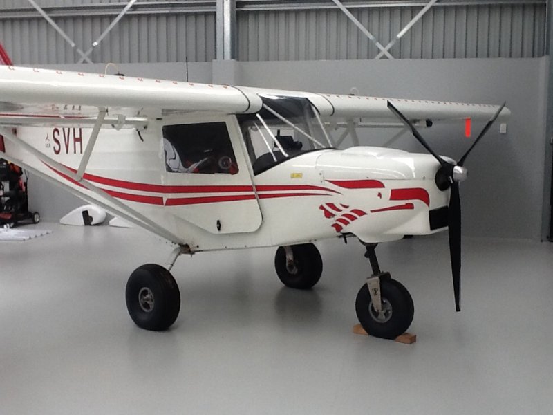

fallowdeer Posted September 13, 2015 Posted September 13, 2015 Hi Lyndon 21/800 x 6 for mains, 600 x 6 nose wheel. Very happy with these. Peter 1
Lyndon Posted September 13, 2015 Author Posted September 13, 2015 Looks nice. Std front fork ??? Brand cost and where to buy em. Lyndon
fallowdeer Posted September 13, 2015 Posted September 13, 2015 Hi Lyndon I imported these direct from Desser Tire and Rubber in the states, their service was great. The mains are Aero Classic brand, only for LSA and experimental and so can't be put on a certified GA plane. The Condor though is OK for that and came with a release form, not that it is needed for microlight here. Like lots of things in life the mains aren't quite 21" but close enough. Landed price with tubes was$900NZD, was a lot cheaper than trying to source them here. Yep, probably cost me a few knots but didn't get this frame to go fast. Did add a few pounds but well, well, worth it for strip work. The aircraft has been landed on gravel bars and the like and I also gleaned a bit more prop clearance from the change. Peter

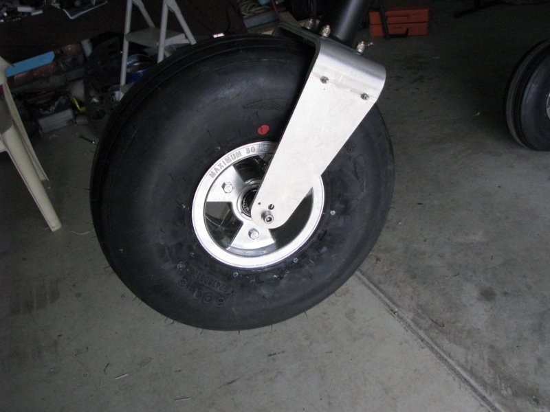

fallowdeer Posted September 13, 2015 Posted September 13, 2015 Hi Lyndon To fit the 600 x 6 Condor I just re drilled the axle hole a little lower to save having to make new forks and reversed the four bolts so the heads are facing the tyres. Peter

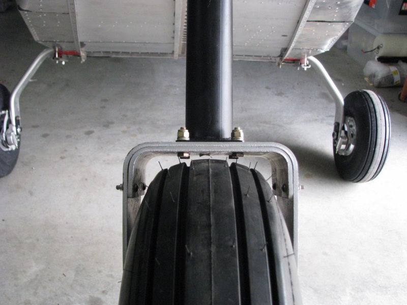

Kyle Communications Posted September 13, 2015 Posted September 13, 2015 The condors for the noseleg you can get here they are used on Cessnas...about 100 bucks well used to be and just redrill the axel hole 15mm down from the original holes. If you look on my build thread I think I did photos there
Kyle Communications Posted September 13, 2015 Posted September 13, 2015 Some pics of when I built mine
