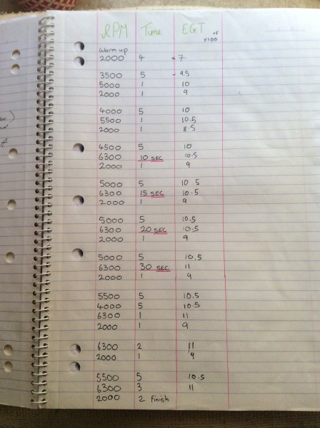

Did you run it in per rotax specs ( takes an hour) and note all temps etc...
Also just as important as correct warm up is the cool down .
Here's my 503 -run in specs...( no cht on the nieuport )
Also the same for my 582...
