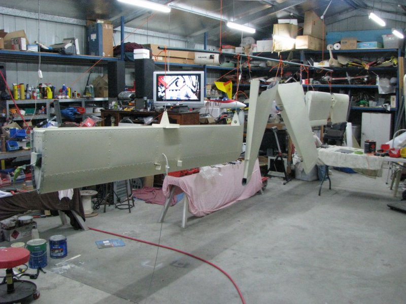

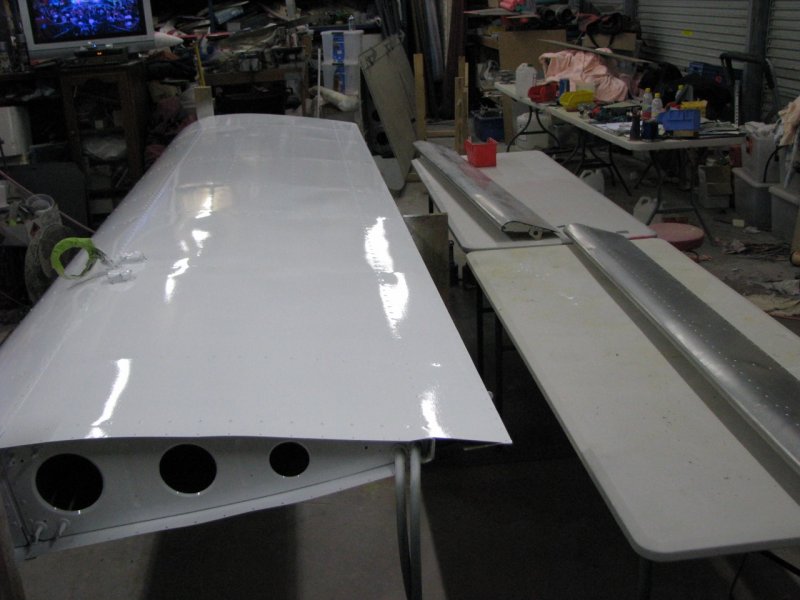

Guy s Posted September 20, 2015 Posted September 20, 2015 Living up Darwin with the summer humidity I would recommend Alodine all he parts for peace of mind but it is a labour intensive job. It you don't then at least use Cromate undercoat primer. Here's a couple of photos after parts have been dipped. 1

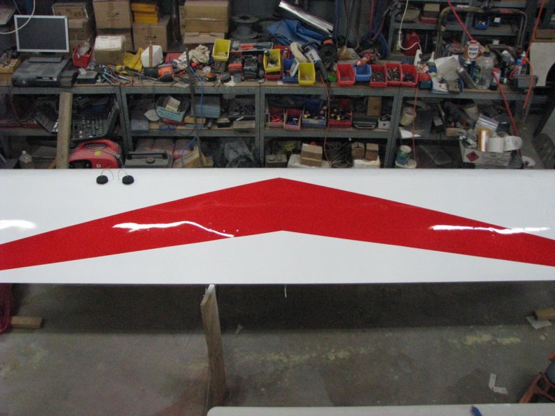

Kyle Communications Posted September 22, 2015 Posted September 22, 2015 I used superetch from wattyl as my etch primer and also used plenty of the black goop on all overlaps. The Savannah has been flying for 3 and a half years and is hangared at Caboolture not far from the ocean. I also fly over the beach and ocean around Bribie Island and Caloundra and accross to Moreton Island and there is not one bit of corrosion on my aircraft anywhere that has been super etched. All painting was 2 pac from Protec
