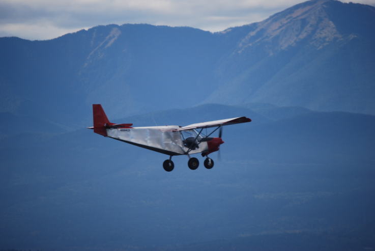

eightyknots Posted October 26, 2015 Posted October 26, 2015 Big in Europe too where they are trying to keep to 450Kg MTOW. It takes hours and needs on going maintenance to keep it looking good. Every dent shows up on the polished surface too, got to really admire a builder of a polished airframe, great care all the way through the build. I have seen all kinds of figures about the weight of paint. One person reckons his Zenith CH701 went up 27 pounds (about 12.3 kg) which is quite a bit for a small plane. Perhaps many layers were put on? I myself much prefer a painted plane even if there is a 5.5 kg weight penalty. The question is, what is the lightest way to paint a plane effectively??
eightyknots Posted October 26, 2015 Posted October 26, 2015 Here is a Zenith CH-701 from the Zenith forum. The builder chose to paint small parts of the plane leaving the rest bare metal. It tends to show the rivet lines more this way.
