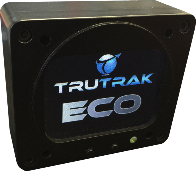

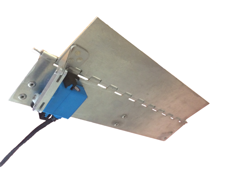

DrZoos Posted September 30, 2015 Posted September 30, 2015 This strikes me as particularly attractive at $999 for ultralights for those that do longer trips. see pics below - look at the tiny servos Not only the price but the fact its massively lighter than a traditional 2 axis auto pilot setup http://www.trutrakap.com/product/eco/ http://www.trutrakap.com/wp-content/uploads/2015/08/Eco-Operation-Manual-prelim.2-small.pdf The Blurb ECO includes: Automatic Envelope Protection (AEP) Heading Hold Track Hold GPS Nav Mode and Altitude Hold SPECIAL INTRO PRICE: $999 AEP is a BRAND NEW safety feature that allows the pilot to set a flight envelope (bank angle and pitch angle) that they wish to fly within. When AEP is armed, the autopilot will monitor the bank and pitch angles of the aircraft and if the aircraft angles exceed the preset limit, the autopilot will apply pressure to the controls and move the aircraft back inside the envelope. ECO Information Eco is a brand new product created by TruTrak and Levil. It represents a completely new concept in how to fly an aircraft. Rather than using a standard autopilot servo which connects to the primary aircraft controls, ECO attaches as a secondary servo tab on the control surface (much like a trim tab). ECO also uses very lightweight, high quality, high velocity, metal gear, waterproof, miniature servos. By using commercially available servos, we can reduce the cost of an autopilot system significantly. The tabs are also sized such that at maximum deflection in the event of a servo failure / runaway the forces are easily over-ridable by the pilot. The photo below shows an example of a servo tab. The tab pictured is 10” long and 4” total width. The production servo tabs will weigh approximately 3 oz.

aj_richo Posted October 1, 2015 Posted October 1, 2015 With a properly designed solid or flexible linkage, the servo could be mounted in the stabiliser or wing, reducing the weight out on the end of the control surface.. The Sonex plans already have a trim tab for the elevator, wouldn't be too hard to add one on an aileron for roll control. The weight savings would be substantial over the Dynon servos I was contemplating 1
Kyle Communications Posted October 3, 2015 Posted October 3, 2015 The servos used for modern RC jets and Imac style aircraft are 40 to 60kg of force...all metal geared etc...the technology has come a long way. I cant see anything wrong with it except the extra weight on the control surfaces
