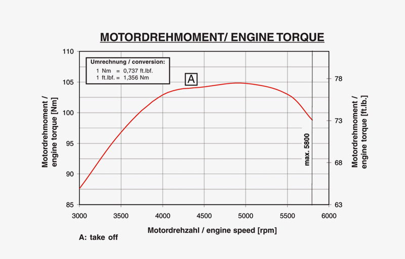

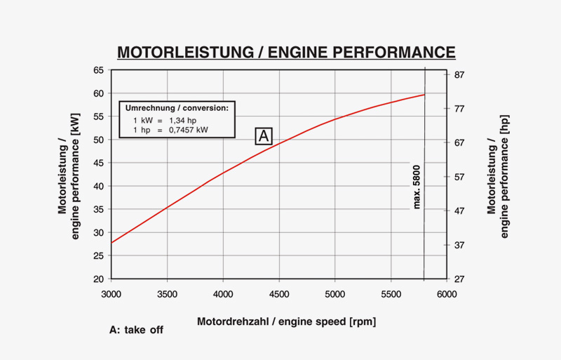

Xavier Posted October 1, 2015 Posted October 1, 2015 Hi all, just to clarify things straight away, my Engine/Mechanical knowledge if very very limited so I apologise in advance if I don't use the correct vocabulary or if the questions asked are silly. I have been flying a Savannah VG with a 912UL 80HP for 6 months now and I am trying to find out if the settings (Engine and Propeller) are correct. The 912UL has 500 hours, the prop is a 3 blade DUC (Diam 68.0 cm, Pitch 13.0 deg). Fuel : ULP95 I am normally cruising at 5000 rpm and getting around 75-77 kt IAS at 4800 RPM I get 73kt IAS, not much difference. Idle is around 2200 rpm (feels a bit high to me) at a TOW of around 520kg - 1 PIC, 1PAX, full fuel (MTOW 544kg): - WOT on take off --> RPM = 5200 - WOT straight level at 1500ft --> RPM = 5250 This doesn't feel right to me. Rotax manual : - Take-off speed --> 5800 rpm (max. 5min) - Max. continuous speed (5500 rpm) - Idle speed --> min.1400 rpm I have been reading the Rotax-Owner forum and it looks like a good balance for rpm settings is to have a rpm of around 5600-5700 on straight level at WOT at the altitude the plane fly most of the time (2000 asl for me). See this thread : LINK So, what do you think ? Is the WOT straight level at 1500ft of 5250 rpm ok ? It would be great if I could get some indications or where to look, prop pitch adjustment, carburetors balancing, other adjustments. Thanks. Xavier
