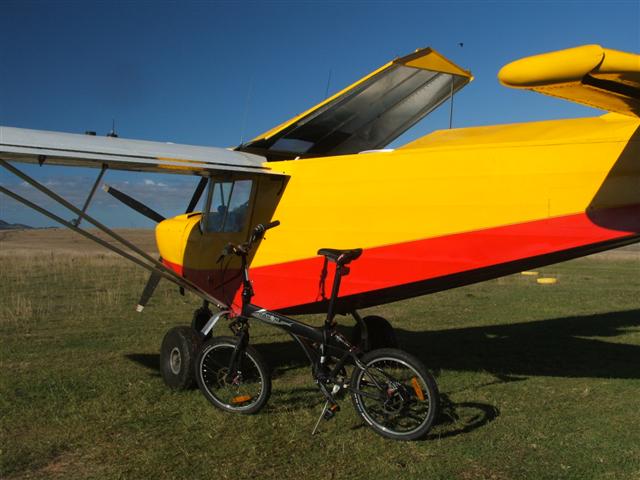

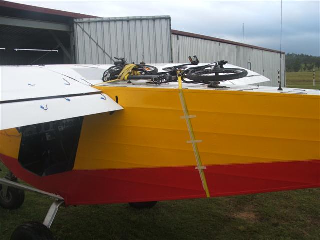

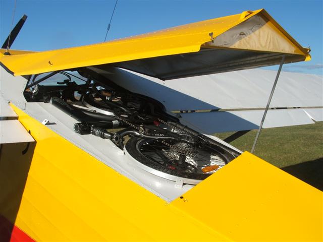

JG3(member on here) puts a folding bike in a turtle deck on the exterior of the rear fuselage, that would work better on the square fuselage of the XL rather than the rounded S model fuselage but it is doable.
It is very cleverly done: kudos to John (JG3)!
Here is the link and the origin of the above pictures from that link: StolSpeed Aerodynamics - Performance Enhancement for Light Aircraft
  • Like 4
Impressive… Thanks both of you for the link and info. So far I wouldn't dare to build something like this. But maybe that's different when you have built an airplane yourself. Btw: What's the effect on the aerodynamics, as one of the advantages of the Savanna over the 701 is that the middle part of the wing also provides lift? But I should rather ask JG3 about this.
