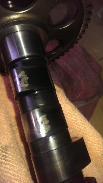

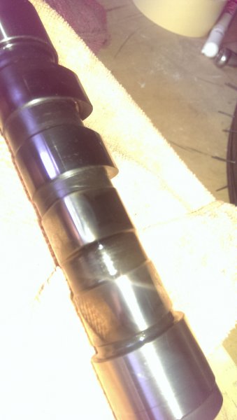

Lyndon Posted January 8, 2016 Author Posted January 8, 2016 Camshaft. After many sleepless nights I'm getting the cam reground along with the lifters. At 150 bucks it cheap and it's done properly. It's very little work to get it out with none or very little cost in parts. As you see it's pretty good. It looks worse than it is as you can only just feel spalling. Strangely it's only on the rear lobes there is wear. Lyndon
