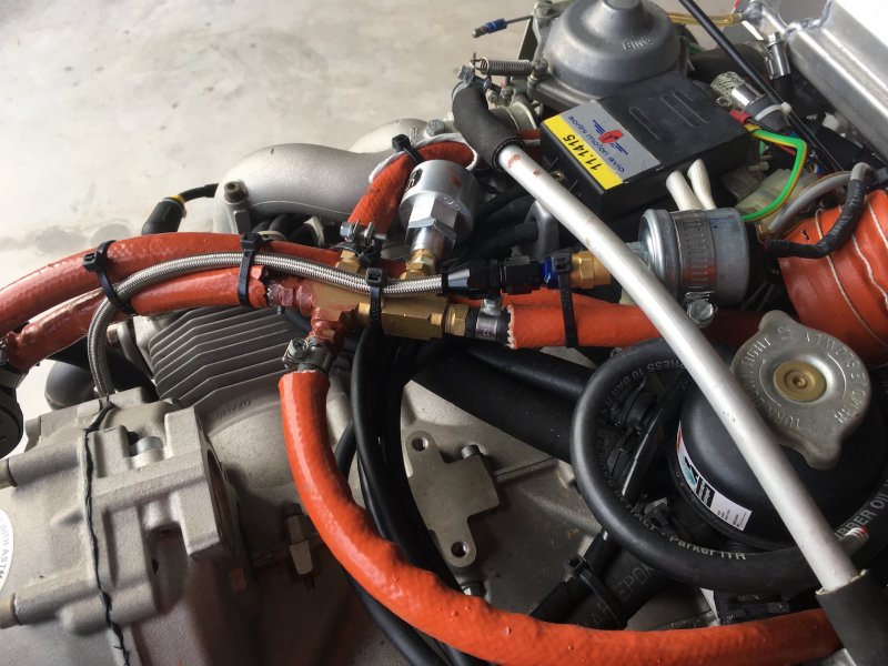

Kyle Communications Posted August 20, 2016 Posted August 20, 2016 Your fuel hose needs to be fireproof or you need to get that very expensive fireproof sheathing and cover it over your fuel lines. Thats why you see all that brown/orange coloured fuel hose. Thats the sheathing
Kyle Communications Posted August 20, 2016 Posted August 20, 2016 The clamps are supposed to cover over the end of the sheath but its too difficult . 99% of the hose is covered

Osteri Posted August 29, 2016 Posted August 29, 2016 My Sav 912 exhaust wrapped with thick glass fiber mat and tied with stainless steel wire 2
Lyndon Posted August 29, 2016 Author Posted August 29, 2016 Looks very neat. I have ordered some. Lyndon
