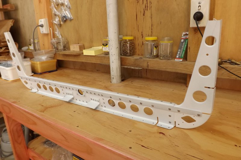

IBob Posted August 31, 2016 Posted August 31, 2016 Amazing. I still can't find this part anywhere in my manual or parts list. But it's an easy installation.Thanks Lyndon Hey Lyndon, I just found a couple more brackets go on this frame. They don't appear on my Frame assembly drawings, but they do appear on the parts listing and the fuse assembly drawings. They are ST062, two simple triangular bracing plates attached to the L and R end of that rectangular doubler in the middle and going down to the fuse bottom skin, by the looks of it. I'm just started assembling the fuse, will post a pic when I have these bits attached to the frame.
Lyndon Posted August 31, 2016 Author Posted August 31, 2016 Can you post a pic of where they go exactly. Lyndon
IBob Posted August 31, 2016 Posted August 31, 2016 Can you post a pic of where they go exactly.Lyndon Yep. I'll do that in about an hour.
Lyndon Posted August 31, 2016 Author Posted August 31, 2016 That's an S. A lot different to my flying garden shed. Lyndon
IBob Posted August 31, 2016 Posted August 31, 2016 Yours will fly every bit as well, Lyndon...friend of mine has one and it's a honey.
