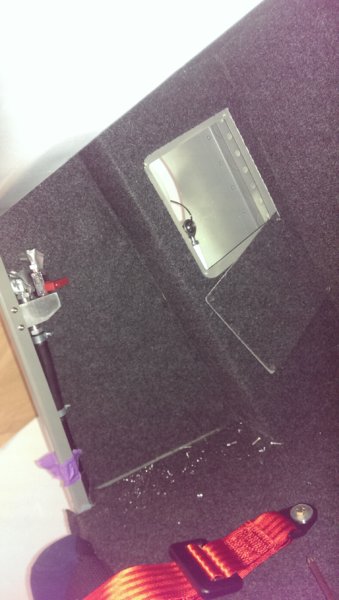

mcrowley Posted September 16, 2016 Posted September 16, 2016 Did you glue it down as well? Did you prime and paint the interior before the carpet install also? I'm at that stage and I keep dithering about putting a protective paint on the interior or just glue the carpet and save a little weight? Thanks!
Lyndon Posted September 16, 2016 Author Posted September 16, 2016 Every bit of my plane is primed in two pack. Have glued onto that. I don't know how much will dissapate but the glue is not light. I'm fitting a big prop. I'm sure it will be slow but it will climb. My thoughts are it will weigh what it will. Saying that I'm keeping every thing to a minimum Lyndon
mcrowley Posted September 16, 2016 Posted September 16, 2016 That's my thinking, I'd rather have long term protection over a few ounces. I'll also be a little heavy but should climb well as I'm building a 3.3L Corvair engine. Thanks for your thoughts, I enjoy your progress!

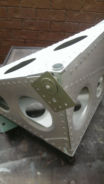

Lyndon Posted September 19, 2016 Author Posted September 19, 2016 I have a question. I'm working in the hole under the plane and have just done all my fuel lines. I must admit this is a lot of fun ?? Oh to be young and fit. My manual states to rivet the brackets on. This is easy without the flapperon unit and impossible with it in place. Before I go and rivet the two brackets ?? They will I take it flex enough for the flapleron unit to be squeezed in between the two brackets. Thanks Lyndon
rick morawski Posted September 19, 2016 Posted September 19, 2016 Quote I have a question. I'm working in the hole under the plane and have just done all my fuel lines. I must admit this is a lot of fun ?? Oh to be young and fit. My manual states to rivet the brackets on. This is easy without the flapperon unit and impossible with it in place. Before I go and rivet the two brackets ?? They will I take it flex enough for the flapleron unit to be squeezed in between the two brackets.Thanks Lyndon No I wouldn't bend the brackets to get the flaps unit in. Do it with the unit in place, not impossible but difficult.
Lyndon Posted September 19, 2016 Author Posted September 19, 2016 Ok will give it a go. The rivit gun actually fit ??. I will limber up and give it a go. Thanks Lyndon Rick the rod arrived. Thanks again
Lyndon Posted September 19, 2016 Author Posted September 19, 2016 Well I riveted the right side. Bolted the left. With the nuts loose I placed the flapperon in position. Then did the nuts up. I couldn't rivet it as I only have the pneumatic one. If I did have an issue I would have a hell of time drilling them out. This way it can be removed easily. Well as easy as it will ever be.I now need a day off for back to recover Lyndon

rick morawski Posted September 19, 2016 Posted September 19, 2016 Next time put it in before you put the seat back/luggage shelf in, much easier on the back.
Lyndon Posted September 19, 2016 Author Posted September 19, 2016 I was thinking that. Pretty sure there won't be a next time but. Lyndon
Lyndon Posted September 19, 2016 Author Posted September 19, 2016 Do I fit bolts and lock nuts here. ?? Or is pretty much good for travel as is. I can't find anything in the manual. Lyndon
rick morawski Posted September 19, 2016 Posted September 19, 2016 Quote Do I fit bolts and lock nuts here. ?? Or is pretty much good for travel as is. I can't find anything in the manual.Lyndon Pretty much good to go with nothing in there. You can put 6mm bolt in to limit aileron travel but I have never used it. Check aileron an other control travel at final assembly.

rankamateur Posted September 19, 2016 Posted September 19, 2016 Quote All works perfectly and it fits The bad news is that the little plate with the four rivets and the bolt through the middle doesn't go there. It's bolt usually has to be moved any where up to half way out to one of the mounting rivet to line up with the flaperon pivot brackets on the wing when you get the wings on.
