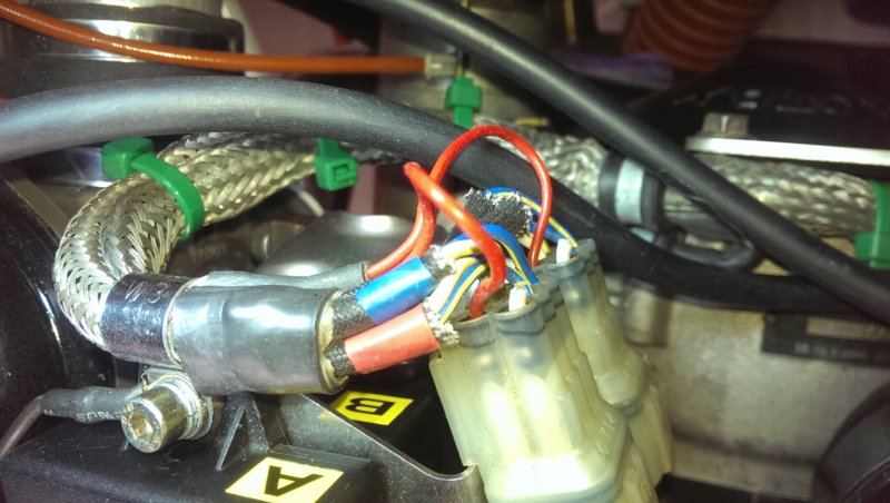

I'm wiring up the engine. Seems a bit of a guessing game with my manual. Anyone have a link to some thing with more detail.
Lyndon
  • More 1
For example. I have the wrong connectors for my head temp sensors. Kit is for a Rotax 912. What is the go. Modify what connecters I have have or replace ??
Lyndon

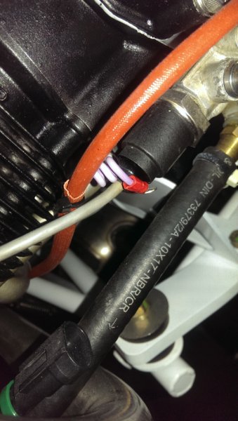

My engine has a honey well oil pressure sender. It has two wires. I'm presuming an earth or a power supply is the extra one. ( my kit only has one wire in the loom ). Secondly will my gauge be suitable for this sender. I see a lot of issues with leaking senders etc. So keep this or just buy the correct sender new.
Thoughts Lyndon
My engine has a honey well oil pressure sender. It has two wires. I'm presuming an earth or a power supply is the extra one. ( my kit only has one wire in the loom ). Secondly will my gauge be suitable for this sender. I see a lot of issues with leaking senders etc. So keep this or just buy the correct sender new.Thoughts Lyndon
The sender is the later 0-20mA type and needs to be used with a compatible gauge(you need a plug and terminals). Your kit probably has the older gauge used with the VDO resistive type sender, but you haven't shown us what type you have.
If there is an incompatibility issue you have to either change gauge or sender. Probably easiest to get a resistive sender because you don't need to muck around with the wiring. Downside is those resistive senders can break down often.
Rick
It seems you can't buy the Honeywell any more. ( So if it fails ). It apparently has the 1/8 th ntp thread. From what I can see buy the the cheap vdo sender that suits my engine and loom. Then remote fit on the firewall. These kits are available in the USA. I would prefer to buy in Australia. Does anyone know availability in Australia.
Lyndon
Ok I have sorted it. I have bought a standard vdo sender. I have some fittings sorted and will mount it on the fire wall. That seems to be the go.

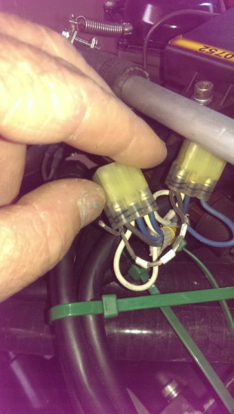

I'm wiring up the mags. From what I can see in the Rotax manual they are brown wires. All I can find is two cut wires in white. One would hope they didn't cut them this close surely.
I'm also interested in why there is a jumper wire joining the coils then it used to go somewhere and that is cut.
Lyndon
Ok I'm sure these two short wires are my mags. The single cut wire goes to my starter for the soft start. The wires are so faded it was hard to tell the colour.
