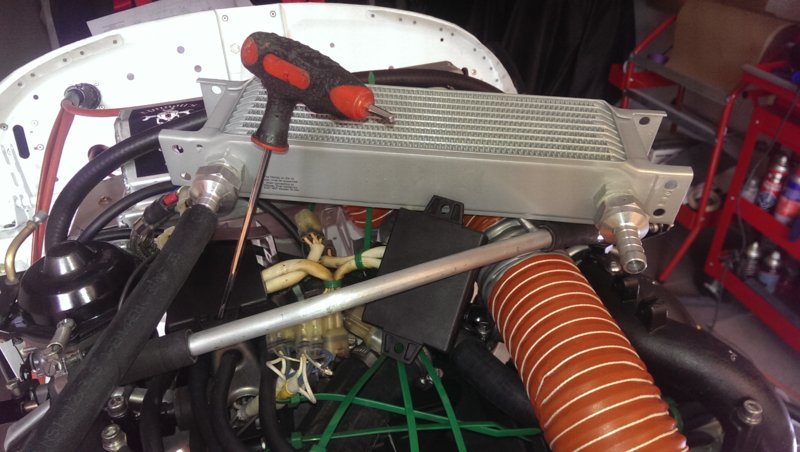

Lyndon Posted September 25, 2016 Author Posted September 25, 2016 My cooler has straight fittings. Is this an issue now or down the road. Everything I can see has angled fittings. Also I have do (not fit on part sf137). I'm wondering why. Lyndon

Lyndon Posted October 5, 2016 Author Posted October 5, 2016 I'm doing the cooling system now. Both my outlets don't match the pump Or the header tank with the the straight bit of hose supplied in the kit that is quite frankly too big in diameter. I presuming the left side of the radiator goes to the header tank and the right side which is the suction side goes to the pump ??. Or are there two huge loops at the rear of the engine . Lyndon
