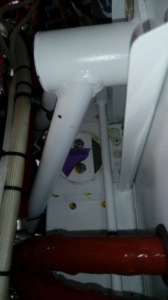

Lyndon Posted August 6, 2017 Author Posted August 6, 2017 I have just noticed my front wheel leg will come close to my throttle linkage. In fact it looks it will hit. Unless I pull it apart to check. Can some one look at their plane to confirm if this correct. I can't see how it can be done incorrectly. But ??? Thanks Lyndon.
skyfox1 Posted August 7, 2017 Posted August 7, 2017 Hi Lyndon I had similar situation on my 701 very close to the linkage so I removed mine and put in a vernier style throttle , cables eliminates all the linkages just have two cables to carbys
Lyndon Posted August 7, 2017 Author Posted August 7, 2017 It does look like it won't clear. From what see the leg has about 3 plus inches of travel. Lyndon

skyfox1 Posted August 7, 2017 Posted August 7, 2017 Yes they work with dual throttles so long as you get the right one so passenger side isn't locked ,gets rid of all that linkage system mine works great
