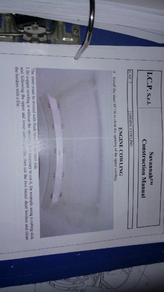

Engine cowl. Im setting this up. From what I see of the manual which is very confusing ...
I have to cut the lower to fit re the muffler.
Then the lower is attached by 1 zus on each side and 2 on the upper. So the lower cowl has six zus fasteners. Then the top is fastened to the lower cowl. Is this all that holds it on ???
Also my manual states a bracket bracket but its not clear where it goes. ( as per pic)
Any help would be great.
Thanks Lyndon
