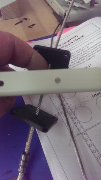

Lyndon Posted October 24, 2015 Author Share Posted October 24, 2015 Ribs ??? A question. Manual is a little vague. On the cables. One nylon block on the rear of each rib. 4 5 and 6. The a block on both sides of the longeron ??? Thanks Lyndon Link to comment Share on other sites More sharing options...
rick morawski Posted October 24, 2015 Share Posted October 24, 2015 Ribs ???A question. Manual is a little vague. On the cables. One nylon block on the rear of each rib. 4 5 and 6. The a block on both sides of the longeron ??? Thanks Lyndon No, leave the most forward nylon block to go on the seat front when you do the cabin/forward fuselage. Link to comment Share on other sites More sharing options...
Lyndon Posted October 24, 2015 Author Share Posted October 24, 2015 Then I seem to have one block left over. I have five of them. ?? Link to comment Share on other sites More sharing options...
rick morawski Posted October 24, 2015 Share Posted October 24, 2015 Then I seem to have one block left over. I have five of them. ?? Have a look in the section called "controls" Should be a picture like the one below. I put the numbers in, see 5 nylon blocks edit : there is a trapezoidal shaped one that goes thu the skin right at the back Link to comment Share on other sites More sharing options...
Lyndon Posted October 24, 2015 Author Share Posted October 24, 2015 Thanks. Looks like number four block goes in between the ribs and the control longeron. Will have another look. Lyndon Link to comment Share on other sites More sharing options...
Lyndon Posted October 24, 2015 Author Share Posted October 24, 2015 Sorted. Thanks two points in front of the three ribs. Lyndon Link to comment Share on other sites More sharing options...
rankamateur Posted October 24, 2015 Share Posted October 24, 2015 These need longer rivets than supplied in the kit too, to do the job properly. Link to comment Share on other sites More sharing options...
rick morawski Posted October 24, 2015 Share Posted October 24, 2015 These need longer rivets than supplied in the kit too, to do the job properly. what are "these"? Link to comment Share on other sites More sharing options...
Lyndon Posted October 24, 2015 Author Share Posted October 24, 2015 Yep I have already fitted a5 rivets . Found that out pretty much on the first one Thanks Lyndon Link to comment Share on other sites More sharing options...
rankamateur Posted October 24, 2015 Share Posted October 24, 2015 Ribs ???A question. Manual is a little vague. On the cables. One nylon block on the rear of each rib. 4 5 and 6. The a block on both sides of the longeron ??? Thanks Lyndon Have a look in the section called "controls"Should be a picture like the one below. I put the numbers in, see 5 nylon blocks edit : there is a trapezoidal shaped one that goes thu the skin right at the back [ATTACH=full]38946[/ATTACH] These need longer rivets than supplied in the kit too, to do the job properly. The standard supplied rivets barely come through the plastic to engage the aluminium. Once sheeted they are very difficult(read next to impossible) to drill out to replace with longer rivets. So that "these" 1 Link to comment Share on other sites More sharing options...

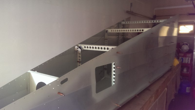

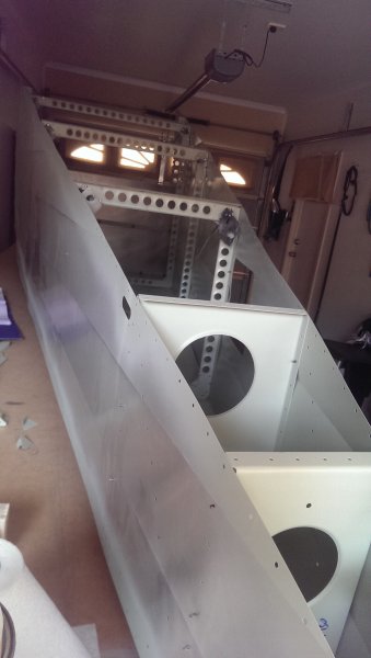

Lyndon Posted October 24, 2015 Author Share Posted October 24, 2015 Gunna have a go at mocking up the fuselage skins today on the ribs. Looks awkward. Any tips. Thanks Lyndon Link to comment Share on other sites More sharing options...
rankamateur Posted October 24, 2015 Share Posted October 24, 2015 Gunna have a go at mocking up the fuselage skins today on the ribs. Looks awkward. Any tips.Thanks Lyndon Get every copper cleco you own ready, anywhere up to one every fourth hole along the outer angles. Link to comment Share on other sites More sharing options...
Lyndon Posted October 24, 2015 Author Share Posted October 24, 2015 Outer. Angles ??? Meaning the four corner longerons ??? Link to comment Share on other sites More sharing options...
rankamateur Posted October 24, 2015 Share Posted October 24, 2015 Make sure when you get to riveting, Start in the middle of each piece and rivet towards the outside. Think "smoothing out the wrinkles". If you go the other way you will carry tension into the middle and there will be nowhere for it to go. 1 Link to comment Share on other sites More sharing options...
Lyndon Posted October 24, 2015 Author Share Posted October 24, 2015 Makes sense. Thanks Lyndon Link to comment Share on other sites More sharing options...
rankamateur Posted October 24, 2015 Share Posted October 24, 2015 Outer. Angles ??? Meaning the four corner longerons ??? Yes. Note they have shorter inner lonerons as well near the front end of the rear fuselage section where the seat backs start. At this point, from memory you end up trying to line up about four layers. Don't drill holes to make them fit, just keep wriggling the holes with a 1/8" mandrel in the hole either side of the cleco until they are happy. Link to comment Share on other sites More sharing options...
Guy s Posted October 24, 2015 Share Posted October 24, 2015 You seem to be powering along Lyndon and it is quite addictive seeing things take shape and forgetting about the going on's in the world and those around you:smile: . As Rankamateur said if you haven't yet then get your hands on plenty of Cleco's. I had my whole fuselage cleco together before I started with the riveting in case of any unforeseen problems. 1 Link to comment Share on other sites More sharing options...
Lyndon Posted October 25, 2015 Author Share Posted October 25, 2015 Happy with it. Time to relax now. One question. Seems to make sense to leave one side off and rivet up three sides. For acces etc. But I'm guessing the answer is get all four clecoed then rivet. Link to comment Share on other sites More sharing options...
Lyndon Posted October 25, 2015 Author Share Posted October 25, 2015 One question. Button up the fuse. Nothing I need to do. Eg cables wiring. ??? All can be done easily afterwards. ??? Lyndon Link to comment Share on other sites More sharing options...

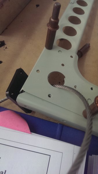

bobcharl Posted October 25, 2015 Share Posted October 25, 2015 Lyndon, Re your rudder cables and wearing blocks. Note that the rudder cables are left and right specific: they are NOT interchangeable. The difference is in the rear block on the cables where they exit the fuselage. The holes on these will not match if they are interchanged. Take care! Regards, Bob Link to comment Share on other sites More sharing options...
Lyndon Posted October 25, 2015 Author Share Posted October 25, 2015 Thanks. Will double check. I believe I fitted them correct but will check with the skins. Thanks Lyndon Link to comment Share on other sites More sharing options...

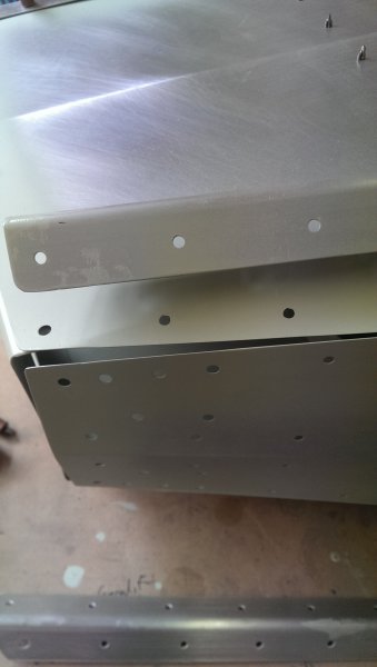

Lyndon Posted October 25, 2015 Author Share Posted October 25, 2015 This is doing my head in. Minor problem the ribs a and b don't quite line up with the bottom skin. The big thing is I can't make sense of the angulars the bottoms make no sense. Holes are completely mis matched. I'm sure it's me but can't seem to work it out Lyndon Link to comment Share on other sites More sharing options...
Lyndon Posted October 25, 2015 Author Share Posted October 25, 2015 Don't match Link to comment Share on other sites More sharing options...
