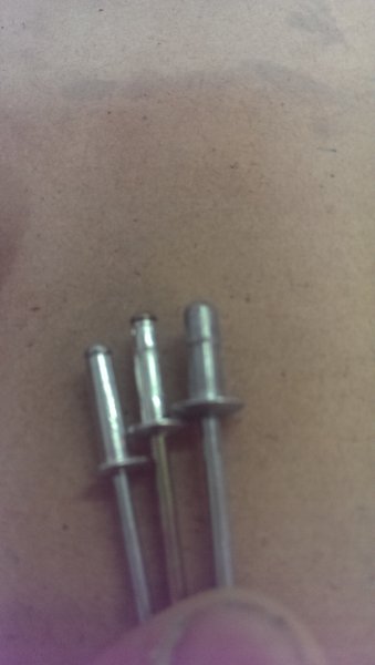

Lyndon Posted November 2, 2015 Author Posted November 2, 2015 Rivet advice. I have bought some longer a4 rivets. They are plain without the center grab section. See left rivet. Kit a4 is in the middle and kit a5 on the right. I have asked one person who said they Will be fine. But before I get riveting I need a hug and someone else to tell me these are fine to use on my aircraft. ??? Thoughts Thanks Lyndon
rick morawski Posted November 2, 2015 Posted November 2, 2015 Rivet advice. I have bought some longer a4 rivets. They are plain without the center grab section. See left rivet. Kit a4 is in the middle and kit a5 on the right. I have asked one person who said they Will be fine. But before I get riveting I need a hug and someone else to tell me these are fine to use on my aircraft. ??? ThoughtsThanks Lyndon No hugs here. Where are you intending to use them? 1
Lyndon Posted November 2, 2015 Author Posted November 2, 2015 Bottom of fuselage. Skins corner with a longeron inside and out ??
rankamateur Posted November 2, 2015 Posted November 2, 2015 They are next to useless. Pull a couple and you will see what I mean. They pull up like macaroni noodles. Make sure and get "multi-grip" rivets next time.
Lyndon Posted November 2, 2015 Author Posted November 2, 2015 No worries. I will chase the correct ones up Thanks Lyndon
rankamateur Posted November 2, 2015 Posted November 2, 2015 Really good picture at the top of this page http://www.stanleyengineeredfastening.com/brands/pop/rivets/types/multi-grip-rivets Look at the picture up the top with the four different thicknesses gripped.
rick morawski Posted November 2, 2015 Posted November 2, 2015 Bottom of fuselage. Skins corner with a longeron inside and out ?? I agree with Rank, useless. That area cops a lot of stress in a hard landing situation. Better use the spec rivets or A5 instead. 1

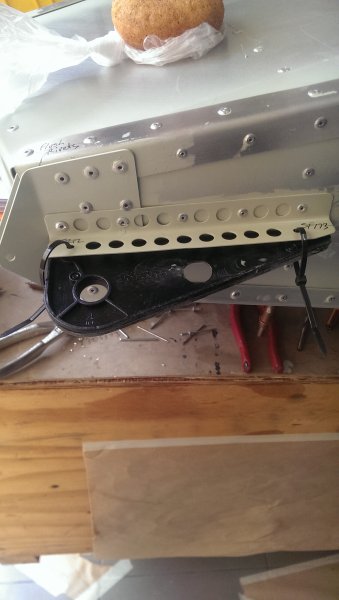

Lyndon Posted November 3, 2015 Author Posted November 3, 2015 Skid a bit ordinary. I'm sure this correct but it's a little agricultural. Lyndon
eightyknots Posted November 4, 2015 Posted November 4, 2015 Skid a bit ordinary. I'm sure this correct but it's a little agricultural.Lyndon You're not going to put a micro tail wheel on your Savannah, just like the Foxbat/A22/Valor?
Lyndon Posted November 4, 2015 Author Posted November 4, 2015 Nope more the way it all fits. Plates overlap and tend to bend in shape when rivets pulled
